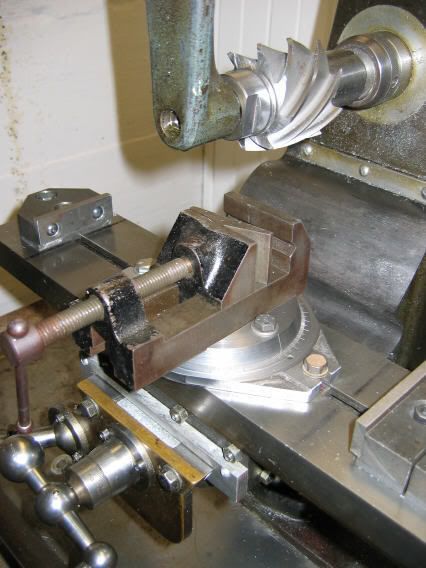

    Decided I wanted a small swivel vise for the Lewis mill....
    Didn't want to spend several hundred bucks, and decided to make a base for a vise I have already, pretty much just because.

    Did you start with castings?

      That looks plumb 'prefessoional' ---is that botton part a casting?.....cant see any tool marks by the ears, and the degree marks look really nice. Yep, real nice!!
        Oh boy!...Now that is some nice! Oh....wait a minute....it's JT....Nothing unusual then. Nice work as always! How did you mark out the graduations on the base?

          Very clean work and nice use of what ya got.

            Nice job. Steel or cast iron? The big question - what is the reason for the big "V" notch in the vise jaw.?

                I noticed that as well, and to me it almost looks like the face on that side of the vise has a pivot point. To hold non parallel work perhaps?

                  Beautiful job JT -- but it hurts to see that crappy Chinese drill press vise on that pretty rotary base.
                  You can get those Chinese "toolmakers" vises for a song, and they're way nicer than the Mill/Drill vises, and they have about the same form-factor:
                  http://www.cdcotools.com/item.php?itemid=25
                    HEY, now.......
                    That is a made in USA Miller's Falls vise with a pivoting jaw....... no chinese whatevers involved. A DP vise? sure..... but I have it, it is actually nice and parallel, and it isn't out of scale for the machine.
                    And naturally it isn't the only vise that can go on the base. The plan is eventually to make a low milling vise to fit it. The net result to be considerably lower than any of the Palmgren units, since I have low daylight overall.
                    Meanwhile, there are lots of the Miller's Falls vises running around, so I have a continuing supply.
                    Nope, bottom is 100% milled out.

                      That looks like what I need for my shaper, only larger and wider. Good job on the index marks. What is that base? A casting?
                        I still want to know how you make the graduations...

                            How about letting us know how you did the graduations !!
