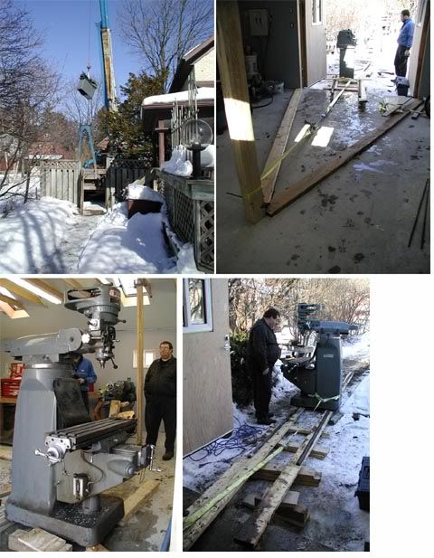

                              Uneven Surface...
                              ...how about snow and ice?
                              I used 1-1/2" x 1/4" wall angle and just slid the mill and lathe along, no rolling required. I had a come-along to keep it from sliding back on the incline and moved it forward with a 5' pry bar. Once I had them in the shop they went onto 1/2" rods and only took one person to move and rotate into place.
