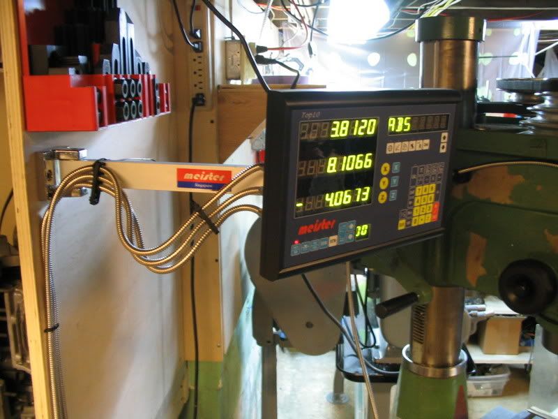

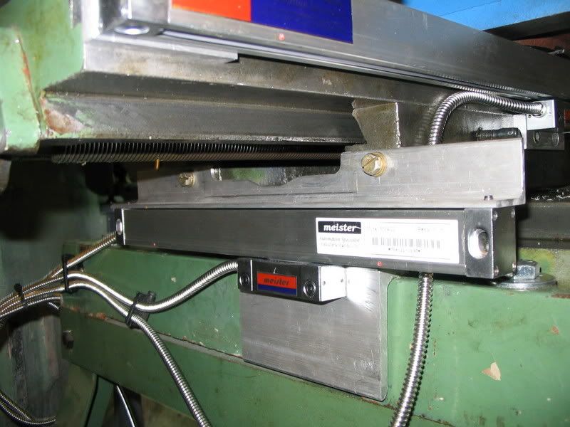

    Hi I just want to share some pics of my DRO installation, on my Enco mill/drill. I also went with the Meister 3-Axis DRO. I know, I know, it's made in China. But, I needed something that had a larger display. These old eyes ain't what they use to be. Anyway, here's a few shots......
    I used some spark plug wire separators, that I got from the junk yard, to bundle the cables.

      That looks like a really solid way of doing the Y-axis brackets. Nice job!
        Nice. Good work. Is it the first time you installed and/or use a DRO?

          Hi Rob, Yes, this is my first time. I never used a DRO. I'm reading the instructions now ...lol. From just messing around with it, such as finding the center of a work piece, I like it already

                      Slowtwitch nice job on the install. I just finished up mounting my Meister BC10 3M DRO on my Enco knee mill. I had it pretty easy because my mill had a Millmate DRO mounted to it before so most of the mounting blocks were already there. I just had to come up with the mounted for the knee axis.
