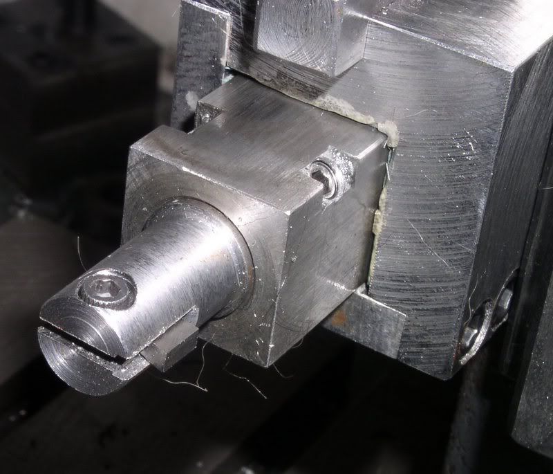

    I had a part that required a small keyway, and after a great deal of ancilliary work it's finally there. The keyway was supposed to be 3/32 wide by 3/64 deep so there wasn't a lot of room to work. The cutter itself is a section from the end of a cutoff tool. It's a T-section 3/32 blade so that part was easy. The holder is slotted to take the blade.
    It's also recessed fractionally since the thick part of the blade is about .100 and I didn't need that much projecting. The bottom that sits in the slot is also ground at about 3 degrees to provide front clearance. No side clearance in this case. A little would be good, but this worked.
    This holder goes in the hand shaper on the QC toolpost.

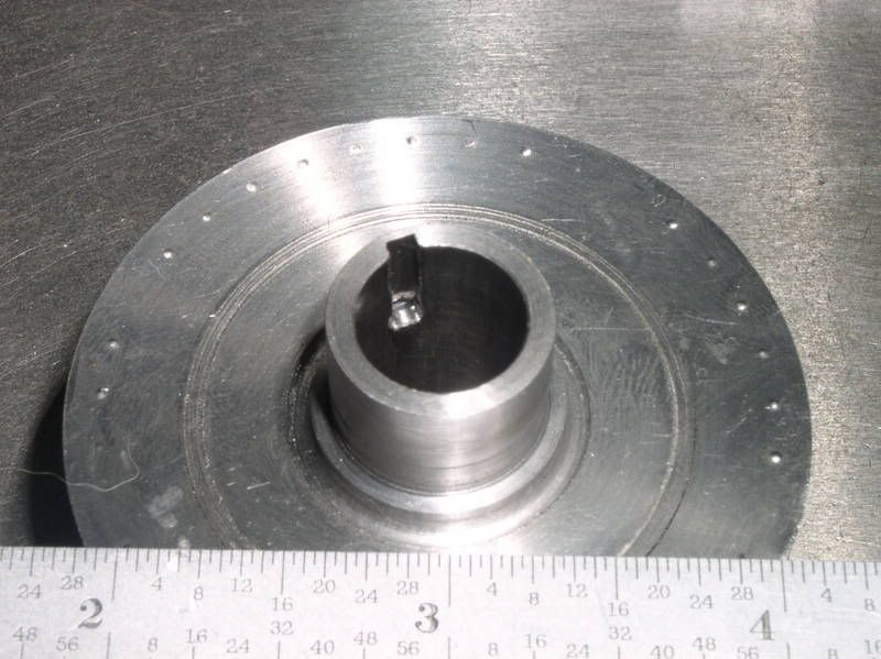

    I don't have infinite stroke, so I made a blind keyway. The cross hole breaks the chips. As usual, getting the tool and setting it up took much longer than the actual cutting. That much was just easy and came out well.
    The final part is a step pulley for a 9mm HTD5 timing belt. Not deburred yet, but it looks like it's going to work.

              It has been one of those jobs where you have to go all the way around the block just to get a start. I didn't have a division plate with the right hole count for a couple of the hole sets so had to make that too.
              A big THANKS to Marv Klotz for the hole program where you can just put in the number of holes you need and the pitch circle and get a printout of all the X-Y locations. Of course there's that bit about subtracting from 100 and taking out backlash in various quadrants. I guess if I weren't doing that I'd be frittering the time away doing something else like improving my mind (or spelling).

                  I've got a catalog from www.econobelt.com which is also Quality Transmission Components. Some dimensions I just scaled from the profile in the catalog. I know the pitch of the belt, and the catalog gives OD figures for different pulleys so I worked out the constants. I can't swear that what I have is perfect but I think it's good. If you're seriously interested in doing some I'll dig out the numbers I used.

                        TG, I sure like that little hand shaper of yours. Is that the same one you showed us awhile back?
                        I have one "in the plans" but may have to do a rethink on it. I never thought of using it in the lathe. My "new and improved" idear wouldn't work for that. Oh ya...I meant to spell idear wrong
                        Russ
                          Russ,
                          Yes, basically the same device. I'd had in mind that it could be used as a hand shaper, but I hadn't used it that way to make sure it worked.
                          I made a new body for it a while back. The original worked fine, but I wanted to see if the Turcite slideways would work. That meant machining the space for the square slide oversize and epoxying in the Turcite strips. So far that also seems to be a good procedure. The picture that shows the shaper also shows the glue squeeze-out at the ends. It won't win prizes as a pretty face, but it can do the lifting.
