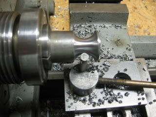

    A while back someone posted that they could not form a large radius on a shaft because they did not have enought power. So I went out to my shop and made this radius turner on my pos Logan. And it works great.
    I am posting this because I posted my answer to my puzzle post [ How did i cut this far around ball??? ] And this is just about the same tool. See other post for more on how it works. And is set up.

    So it's a bit like this one posted here March 2004 that I built for making Delrin rollers to roll on 2" tubing for door supports ?
    Nothing special, no mountings, just removed the tool post and used the existing bolt. This lathe doesn't have a top slide fitted for rigidity that block is semi -permanent.

      Jim, is the end of the vertical stud the actual cutting edge or do you have small bit embedded into that riser?

          You asked if the vertical stud [ cutting tool ] was the actual cutting edge.
          Yes it is . In fact you could use any hss round even a broken tap shank.
