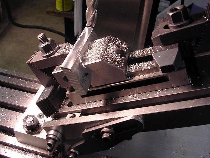

    'Nudder project finished...and in a less than a weekend even!
    I was trying to tackle aligning the headstock and tailstock on my little lathe using the "Rollie's Dad's method" mentioned elsewhere. Early attempts at measuring runout using a magnetic D.T.I. stand were frustrating and inconsistent so I decided to make a dedicated holder for my Q.C.T.P. I keep forgetting to buy a dovetail cutter so I made this holder from separate pieces using the tilting angle table to cut the 60 deg. angles. This is the 1st really useful job i've done with Mr. Ishimura's table design and it worked great!
    I used some aluminum I had lying around since it won't see heavy pressure and a piece of shafting liberated from an inkjet printer for the gauge mount shaft. I made it long enough to reach bigger chunks I may need to dial in later. The clamp block is 1/2" CRS drilled & reamed to fit

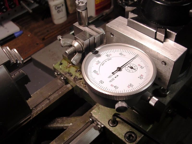

    I'm not really happy with the clamp knob...I hate having to fumble around with a wrench to adjust it but a big enough knob to give sufficient clamping would hit the chuck jaws when using it on short parts. At least it gave me a reason to use the spindexer to make the tube nut. Only lost focus once and mis-cut a flat.

        Thanks guys. I built the angle table based on Mr. Ishimura's plan on his great website. He's an inspiration to me.

          Just a thought, could you have made the end of the nut as a thumbscrew style? That way you would have plenty to grab and tighten and it could be the same size as your nut head so it would clear the jaws. Just a thought.

            Thanks Cybor. I actually made a thumbscrew larger than the nut with a knurled rim but couldn't get enough torque on it to lock it down. A much bigger one would do tighten up well but would hit the jaws on small jobs.

                  I have one suggestion for you clamping/holding dilemma. Why not use what is sometimes called a "split cotter" design? It locks much more securely with less pressure on the thumb screw, so a small brass head would be fine. It's similar to the way tools lock into a turret head, which is a non-split cotter I guess.

                    Thanks B/D. My table is piece of a H/F Micro-Mill (X-1) I got it a few yrs. ago from Little Machine Shop. Seems like it was only $25-30.00 at the time. Mr. Ishimura made his own t-slot cutter and slotted a chunk of Dura-Bar to make his. I ain't quite there yet!

                      Imagine a vertical hole to hold your vertical bar. Then drill and bore a hole horizontal that protrudes about 1/4 diameter into the vertical hole. Now make a pin to fit that horizontal hole with a smooth slip fit, drill the pin through and tap on one end. Lock it in place somehow such that the top of the pin is just above the surface of the block, and the threaded end is at the bottom. Now drill/bore through the cross pin so you take a bite out of the side and the vertical bar will slide smoothly through. Remove the cross pin and cut straight through the narrowest portion. Drill non threaded portions of cross pin with clearance drill for thread selected. Now put a thumb screw to hold the 2 pieces of cross pin (the "split" cotter) together and insert into block. Line up "bite" and insert vertical rod. Light thumb screw pressure will lock it securely.

                            So, what was the 1st thing I needed to use my brand-new indicator holder on? Yup, piece of square stock in a 4-jaw which needed way more travel than the little D.T.I. could measure.
                            A couple more clamp blocks and a spacer to fit a 1" travel D.I. and the job was easy! It's looking pretty cobbled up now but it's very rigid and works.
