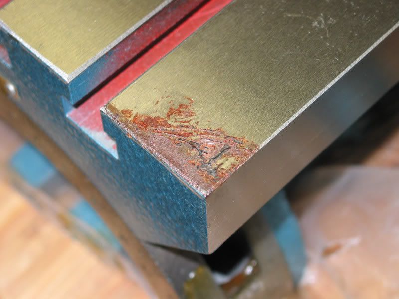

    I lost the Chicom lottery again
    I bought a tilting angle table from Enco, and it was covered in cosmoline everywhere except the corner, which is deeply rusted from the saltwater air on the ship coming from China:
    This is the 7x10 table with the worm drive, so it weighs around 50 lbs. Is it worth sending back, or should I just scrape-out the rust and call it even?
    I would just clean it off and use it. It won't hurt anything. However, if you are a fanatic about the condition of your tools and machines then send it back no mater how much it costs because you will never be happy.
      Rust
      Lazo
      I agree with Carl - sand it off and forget about a little rust in that location. I would start by contacting ENCO and see what they offer. The little rust will not hurt anything if the area is sanded/stoned down to the machined surface.

          The grind looks decent in other areas. I brush off light rust with a stainless steel brush, single direction strokes and some Starrett M1 or light oil. The pit marks will always be there but I'd give it a light stoning to be sure there are no raised areas. Other than cosmetics, how often are ya going to depend on the bearing area of that corner anyway
          Looking at the image again, you may be surprised at how much of it is outward growth that comes off easily, leaving a lot less damage than you think ... maybe

            It's hard to tell from those pictures, but the swirly patterns are actually etched into the surface of the table. In other words, it's not surface rust. The amazing thing is that you can see that the rust pattern is triangular shaped -- the guy that was coating the tool in cosmoline must have left a flap of the shrink wrap flap over the top of the table, missing the corner. I'm astonished that it would rust that much in overseas shipment!

            As you say, the surface of the table is nicely ground, and the fit into the curved ways is actually pretty nice. What's really disappointing is the worm-drive is really, totally, completely crappy. It's got backlash of at least a half turn of the crank. A lot of that is really sloppy fit between the worm and the worm wheel (the base of the table), but a lot of it is from a very primitive set of pillow blocks that hold the worm. The pillow blocks I can replace, but from playing with it, most of the backlash seems to be in the loose fit with the worm -- is there any cute way to fix that other than cutting a new, non-standard worm to fit the worm wheel cut into the base?

                I went and looked at mine and I guess you could bore the worm bearing area out and bush it with brass off set to close the gear lash some.
                  Hand Hone it
                  Hand hone with stone then rub oil into it good as can be.

                      I doubt it did. It's only about 18 days by container ship from China to here plus the item is packaged, palletized, and in a container. Containers aren't airtight but they float, for a while. The pattern looks more like it was in contact with something that ate it, maybe stacked on another part that had some pickle solution on it and left some on that corner. That would promote corrosion the entire time since it happened.

                            Show us the pix after wire wheeling. Hard to tell from those which honestly don't look that bad as several have said. It isn't in an especially sensitive place anyway. You don't want to clamp way out on the edge or the table will likely flex.
                            I just got done going over some surface rust on a piece I bought from someone. They had cleaned all the cosmolene off with something like brake cleaner (no trace of anything resembling oil) and then just left it sit. It looked bad, and I was annoyed, but it cleaned up completely.
                            Be sure to apply something protective ASAP. Rust, as you know, grows on itself. I like to use Break Free, which many in the firearms crowd use. WD40, as you probably also know, is not a great rust preventer. Any new tool that walks into my shop gets a rub down from my spray bottle of break free. Any machine tool that I give a thorough cleaning to gets a follow up.
