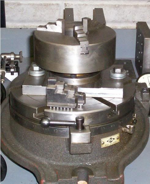

    Can anyone shed some light on the make of this rotary table? I believe it says ASH Made in Japan on the tag. This is amongst some tooling I'm buying, so I don't have it in hand to look over more closely. A search of my usual sources (google/ebay) hasn't turned up any info. Almost all of this tooling is decent quality, so I would be a little surprised if this turned out to be a no name. Thanks in advance for any info. SG
    looks more like dsh to me then ash.....
    It "may" say made in germany under that.....
      What little I can see of the table very closely resembles my NEWS tanle. NEWS was made in Japan and was the predecessor of YUASA. If so it is of very good quality.
      ASH was an importer of tools and tooling comparable to ENCO and Ralmike. Prior to the influx of chicom tools, they provided good quality imported tools under their lable.
      Jim H.
        Sounds good, thanks for the info!
          I am in total agreement with gentleman Jim !
          I also have a NEWS 12 inch rotary table and
          it looks exactly like the picture..
          I's a nice table!
          I was advised when I purchased it new in 1984
          that it came from the Yuasa Factory..
          Crate was stamped "made in 1974" so I got a good deal.
          The tables came in several ratios
          90 to 1 ratio (4 degs per hand rev)
          80 to 1 ratio (4 1/2 degs per rev)
          and maybe a 120 to 1 ( 3 degs per rev)
          Rich
          Green Bay, WI
            That's a nice Rotary Table a bit too big for my mill but looks good cant help with the name sorry.Alistair
              Info on ASH
              I remember that company. They had a mailorder setup like Enco and were out of Tampa Fla. I even bought some tools from them. They went out of business some time around 1979. They just dissappeared off the face of the planet. Too bad, they had good quality tools and were nice to deal with.
              Jim (KB4IVH)
              Only fools abuse their tools.
                I had one years ago and ash . It is a direct copy of the News brand made in Japan common in the 70` Whole sale tool use to sell them in the 70`.They are a good table. Better than chineese stuff to day.
