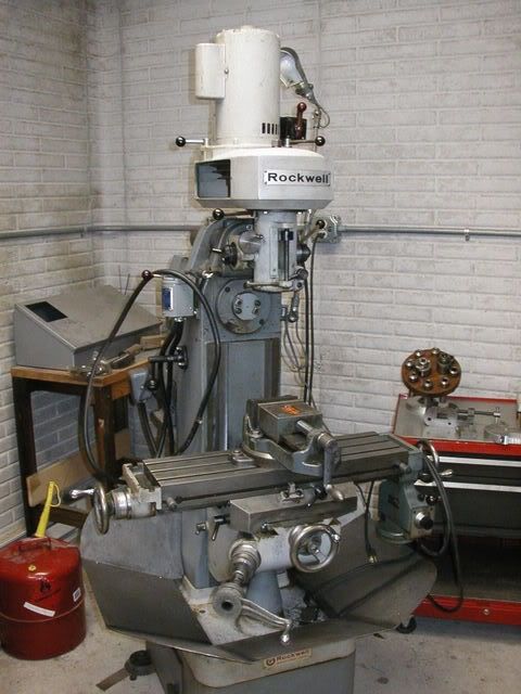

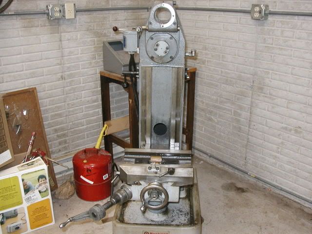

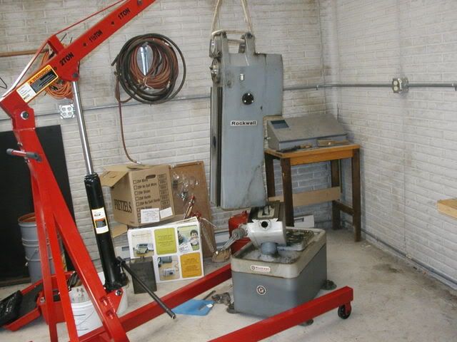

    Here's a coupla quick pics I took of the dismantling of my Rockwell H/V mill for a move to the basement. I don't know why, but it seems like everytime I intend to take some pictures, I end up forgetting until just about the end of the project. Anyway here you go...
    From this
    To this
    this
    Having never done this before, I went pretty slowly/carefully and packed about a half-dozen baggies with the small bits and some notes indicating where they came from. Took about 2.5hrs total. I think it will go back together in half the time though. The engine hoist that I really didn't want to buy--for just this mill/lathe move--actually came in very handy. I can see it being pretty useful down the road. I couldn't raise the knee high enough to get it off the column because of interference with the horizontal spindle (which I really didn't feel like pulling out). Instead, I cheated and pulled the column up from the base/knee with the hoist and set it right on a hand cart. Worked like a charm! I also got a few weights if anybody's still reading this:
    Vertical head complete with motor...135#
    Table and powerfeed...106#
    Horizontal motor and mount...77#
    I think the saddle was about 40# and would guess the base and knee at maybe 150# total and the remaining chunk of column/horizontal spindle/pulleys/backgears at 400-450#. It sounds like alot but is actually pretty managable--although I don't have it downstairs yet SG
