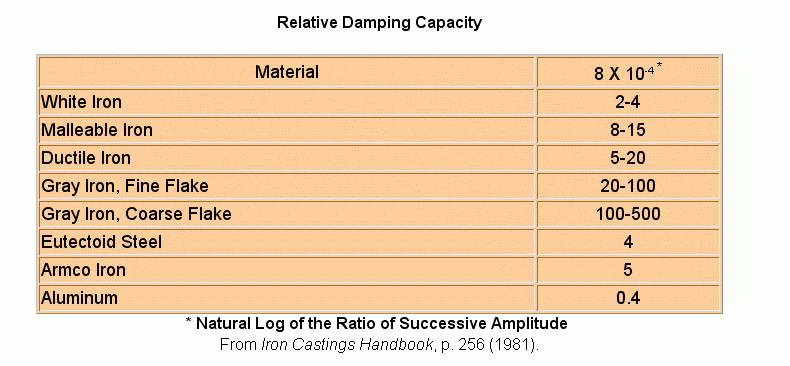

                        Gray Cast iron damps vibration 25 - 125 times better than steel. Steel, in turn, damps vibration 10 times better than aluminum.
                        In other words, gray cast iron damps vibration 1200 times better than aluminum:
                        If you go to a local DuraBar distributor, they like to demonstrate the superior damping characteristics of gray cast iron by hanging a 1 x 6" bar of steel, aluminum and gray cast iron by strings, and whacking them with a ball peen hammer.
                        The aluminum vibrates like a tuning fork. The steel rings a lot less. And the gray cast iron just makes a dull thud.
                          I don't dispute that. However, the ringing effect can be damped by proper design and a material cannot ring unless it is free to resonate. Ringing is a resonance phenomenon. All it takes to make a bell stop ringing is a small amount of extra mass placed in the right spot or simply picking a shape that has no resonance modes that reinforce (cracked bell for instance). There are many ways to dampen ringing. In the design of my milling machine I used a variety of methods including the use of dimensions for various parts that are different prime numbers, the use of golden sections and the use of multiple layers of material of different masses. By doing this excellent damping can be achieved regardless of the material.
                          The difference in Young's modulus is much harder to deal with in machinery design as it requires greater bulk to achieve the same rigidity with aluminum. There aren't any shortcuts to achieving a greater modulus of elasticity. This is shown by the fact that all steel alloys have nearly the same modulus.

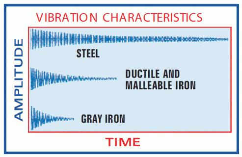

                            Another pictoral showing the amazing vibration absorbing capabilities of gray cast iron:

                              Two layers of aluminum with an adhesive between is better. The point is that the material must be free to vibrate for it to matter. Even if it is free doesn't mean it will vibrate. Cast iron makes a lousy tuning fork. So does aluminum if the forks are different prime lengths.
