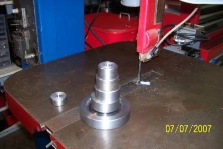

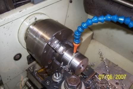

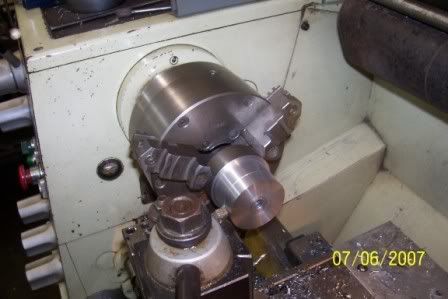

    Needed a project this week end .So i set up and made 5 gears for one of our members. who needed the for a 1909 lathe he is restoring. Here are some picthures.
    Turning gear blanks.
    Parting off blanks.
    Stack of un cut blanks.

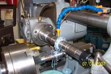

    Cutting 20 tooth gear.
    More cutting.
    Finished stack of 14 DP gears Five gears 20 tooth 24, 28 , 32 , 60 tooth .

                          I have a couple of questions that I would like to know about for example. I would probably use a shaper to cut gears even though I have a horizontal mill. I say this because I don't have a bunch of the involute gear cutters around. If, however, you are using a mill, do you take several passes on each tooth or cut at full depth, slowly? If you can do the latter, it has to be *much* faster than a shaper ever would.

                            Gears scare a lot of people but they are fairly simple. most good machinist books have all the formula`s for figuring out what info you need. Yes I have a set of 14 diametral pitch gear cutters . their are 8 cutters in a set.
                            Cutter # 1 cuts 135 teeth to a rack.
                            cutter # 2 cuts 55 - 134 teeth.
                            " # 3 35- 54 "
                            " # 4 26 - 34 "
                            " # 5 21 - 25 "
                            " # 6 17 - 20 "
                            " # 7 14 - 16
                            " # 8 12 - 13
                            You can`t cut any thing less than a 12 tooth gear. I needed a 20 tooth ,24 , 28 , 32 , and a 60 tooth gear. 20 tooth cutter # 6 24 cutter #5 28 cutter #4 , 32 cutter# 4 and the 60 was cutter # 2.
                            The cuts were made in one pass .154 deep 130 RPM at feed rate of 2 inches per minute. On a large gear 8 DP are less I would cut around twice a roughing cut and about 10 -20 thousand to finish. You can hand grind a bit to make one or two gears but too much trouble . gear cutters are cheep if you know where to get them. I have 2 complete sets and a bunch of different ones in different pitches.Years ago at a place i worked we fly cut gears for one of a kind jobs ,but you spend too much time trying to get gutter ground.
                            It took 2½ hours to turn the blanks about 30 minutes to set mill up and from 12:00 - 7 :30 to cut gears and clean up shop.
                            While the gears were cutting I was fooling around with other stuff. Just back out cutter index and go again.
