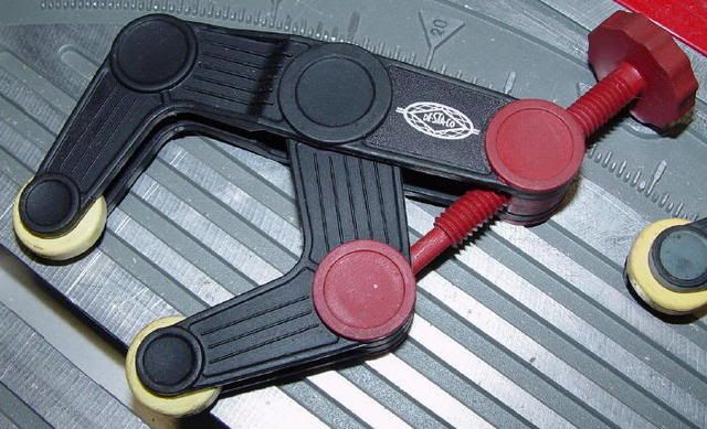

                              Here is a De Sta co plastic welding no mar clamp with the wheels instead of pads.
