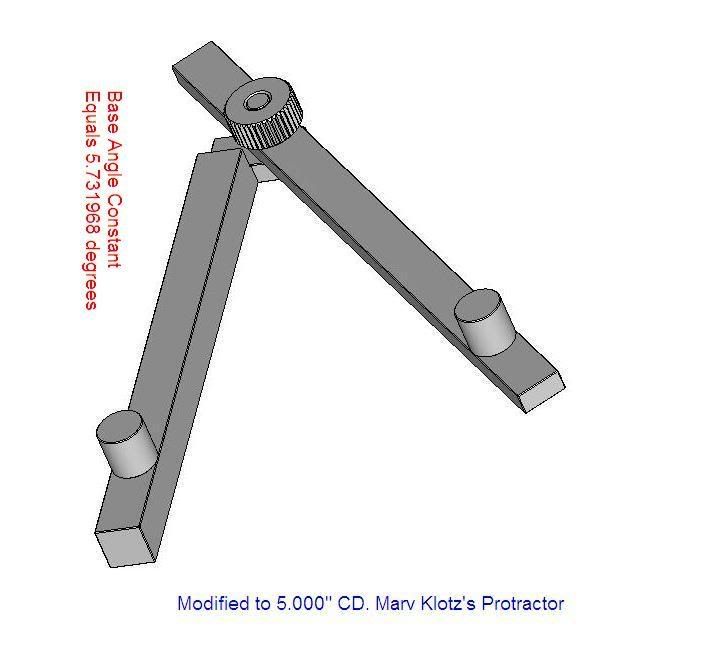

  • LES A W HARRIS
    replied
    Originally posted by lazlo
    That's very clever Les. So Theta simplifies down to:
    Θ = 2 Sin-1[d+D/10]
    Now that's something you can do in the shop without a bunch of keypresses!
    Minus the Base Angle Constant!
    2*INVSIN ((.5000"+3.3858")/10) - 5.731968deg
    40.00038deg
    Closer than my eyeball!
    Drawn at 40:00:00

  • lazlo
    replied
    Originally posted by LES A W HARRIS
    Marv, Nice job, thanks for sharing.
    Tweeked a bit, rolls at 5.000" C.D. & zero gap at zero angle.
    Θ = 2 Sin-1[d+D/10]
    Leave a comment:
  • LES A W HARRIS
    replied
