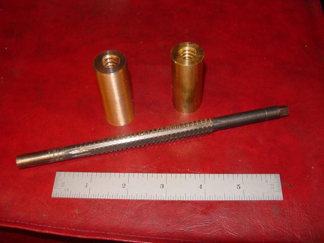

            Below is a tap I made to cut 1/2-8 LH to make tailstock nuts for my 10EE. A2 so it wouldn't warp too bad. I didn't get enough relief or enough gullet in front of the teeth so it's a real PITA to use, but for occasional use it's fine.
