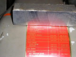

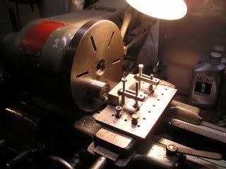

    I was trying to square up some stock in the lathe , it is clamped to the compound, here is the setup
    it is cutting ok and the finish is good the problem is that it acts like a mill that is out of tram.the first part of the cut is down when it gets to rear part of the cut cutting up it is cutting deeper about .002 ,
    what is causing this. what am i doing wrong or what wrong with my lathe?

    Its a well known problem but i cant remember the cause. Most lathes are designed to cut from the centre out or from the edge in, you would not normally allow the tool past the centre point, in which case the fault would never show up.
    The only suggestion i could offer is to increse the swept diameter of the tool so it does not cut on the back stroke. It is probably caused by some minor inaccuracy in the saddle alignment or may be designed-in on a lathe. How about a milling cutter in the chuck and a vertical slide?

      I have just read in chap 2 of Tubal Cains "milling in the lathe" that a lathe cross slide is not exactly at right angle to the mandrel axis perhaps .002 003 per foot, maybe this is it,,?

        Are you sure the work is parallel to the chuck?
        If you think your cross slide is not square to the bed, that is parallel to the chuck then chuck up a short piece of round stock about 3" dia. Take a cut down the side of the round stock and then face it. The side should be square to the face cut. If not you have a problem and now know why you are getting bad results.
        A lathe should hold very close to square for face cuts.
          It doesn't matter whether the work's parallel to the chuck, as the cutter will make it parallel to the table travel.
          The only two issues I can think of would be the work slipping in the hold-downs, or the cross-slide having some slop in it, so that the upstroke moves the slide slightly, in a way the downstroke doesn't.
          On that same note, I suppose I could see a loose headstock bearing doing the same thing- allowing a slightly different positioning as the cutter goes from the upstroke to the downstroke.
          Either way, the fix would be, as Dave noted, to increase the tool swept area, and only cut your workpiece with the bit going one direction, not both.

            The problem IS as described in the Tubal Cain book, he states that a lathe when correctly set up takes slightly more off at the center than the edge,

                As I know alittle about this, Mr. Cain is correct. It is accepted practice of scraping in the lathe carriage in mfg. to "throw" the crosslide. A facing cut should be about .0002 to .0003 concave. The idea is that the facing cut stock should be able to sit flat on a smooth surface. I think the .002 error is alittle much but a good indicator and a parallel in a four jaw should illuminate the problem.

                  Absolutely right.
                  Lathes are set up to face ever so marginally concave so that the the faced end doesn't wobble like a weeble.
                  On Myfords for example, the carriage is set to face concave by 0.001" in 12".

                      No need to guess, it's easy to determine whether your cross slide has the slight angle suggested in Cain's book.
                      Make a small circle near one edge of the face plate, mount an indicator on the cross slide and indicate the circle when it is at about center height on the near side and lock the carriage. Then rotate the faceplate 180 so the circle is at center height on the far side and crank the cross slide out to indicate the center of the circle again. The difference in readings divided by the distance between measuring points is the "error" per inch.

                          I got out the accuracy test record for my lathe and looked up the facing cut part. It starts out by stating, "To face hollow or concave only on 12" diameter" and went on to give the dimention achived. While I don't always believe the dimentions written in factory accuracy test sheets, the fact that they test each thing gives insight to what to look for.
                          Sooo, apparantly the lathes are set up to face concave as Mr. Cain states.
                            Pick up a copy of "Milling Operations In the Lathe" by Tubal Cain and he explains it quite clearly. It is the way lathes are normally designed and made that makes it do thusly.

                              I did as suggested mark the faceplate and rotate 180 while measurin with an indicator mounted on crossslide it was about the same maybe a tenth or 2
                              (0001)difference,, also while the indicator on faceplate about 3 inches from
                              centerline i pushed and pulled the edge of faceplate towards the tailstock about 30 lb push and pull and could measure about .003 deflection is this too much?
