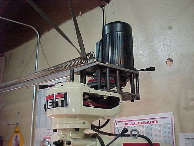

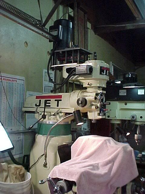

    About 3 years ago, I bought a Jet JVM 836-1 milling machine, a great machine for the price, but somewhat limited by having only 5 speeds, 240-1550 rpm. Based on a photo posted by Lane, made this milling machine "transmision", I now have 20 speeds, from 80-3100 rpm, much easier now to select the proper cutting speeds. At the same time I installed a 4" riser block in the mill column, a Grizzly piece for their G6760 mill, identical to the Jet mill.

            Studying second pic - wondered what in hell that big ass spring was for??

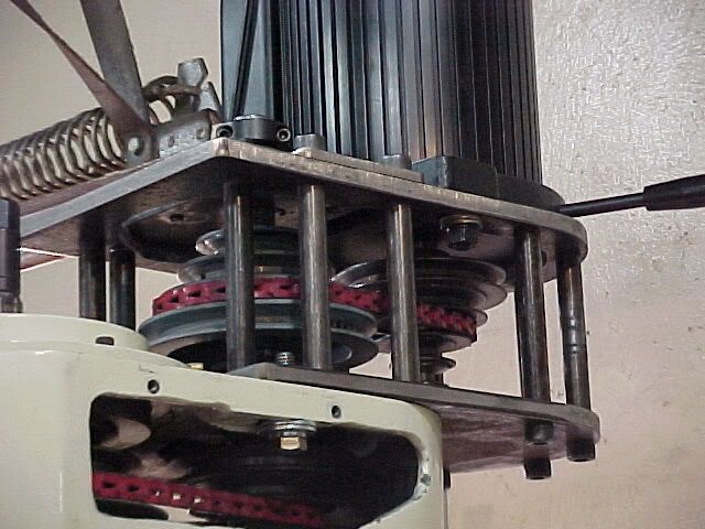

            Third pic splained all!
            Pretty sweet change box, is the belt tension on an excentric?
              Belt tension
              On one side of the plate there is is a pivot bolt and the other side of the plate is slotted with a clamp bolt going through, pull the plate back to the right tension, then tighten both bolts. The system is used on the transmission to the mill, then on the motor to the transmission. The tension on each section is set seperately.
              Big a$$ spring is on the overhead door track.
