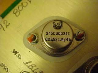

    I posted this same request over at the PM forum, so forgive me if I seem a little desperate. I have this AB power transistor number, but have been unable to locate a cross reference or source to purchase same. The number that I believe to be AB's is 245D00031E. Since the device came from A CMC Servomate SM1, I have the schematic and it is listed as component Q7 bearing their part number 29782LG. I know there are some real electronic guru's here so, I may have a better chance at success with you guys.

    AB doesn't make power trans, I can just about guarantee you that. What they do do is to buy a large lot and have their own custom number and logo printed on them.
    Keep checking for a cross ref. trans that well fill the bill or just plain break down and call AB and talk to their service techs. If by any chance they have discontinued the use of that particular part they will be more then happy to give you a replacement (stock) part number
    But....
    In the past I had this problem with Motorola SCRs which were very rugged and well made. The problem was there were no more of these Motorola SCRs available. The replacement held up electrically, performed beautifully, BUT did not have the same heat dissipation characteristics of the original.
    Simple fix, I had to ad a fan to the power amp is was in and the thing worked fine

      That is absolutely an Allen-Bradley in-house part number, and bears no relation to any other numbers, as far as I can determine.
      Failing getting the part from them, the only recourse is to reverse-engineer it, looking at the schematic and usage of the part to derive the requirements for a suitable substitute.
      In these days, when bipolar transistors are getting rare, especially in the TO-3 case, that might be challenging.
      A glimpse of the schematic might prompt some more questions and get to a sub......
      What kind of circuit is it from? Something that is potentially a switching type drive or power supply? Or a "linear" type circuit? The latter will be easier to cross, as switching bipolar transistors 'went away" longer ago than linear.

        So far everything I have tried has come up empty, including Allen-Bradley (now part of Rockwell Automation) parts department. AB has created a "case number" and will have technical support research the part number and call me back if they can find out anything about it.
          Post the part of the circuit it is found in. It may be possible to cross-reference it. If it's an old germanium transistor you may be SOL but if it's simply a common NPN or PNP switching power transistor and the voltages are known there may be many substitutes including the ubiquitous 2N3055. If it is in a balanced analog circuit then it may still be substitutable but should be swapped out in pairs.
          Just be warned - without seeing the circuit it is in it is not possible to know with any certainty that it is even a transistor. It could easily be an SCR or even a diode in sheep's clothing.
