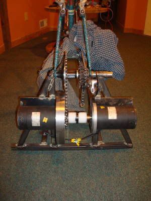

    I finally got me a nice digi cam and wanted to post the pics of the bike dyno,
    Note that they are from a distance so as to not let torker get an up close look at my welds, all he has to know is the steel will tear before the weld fails --- even though they are as ugly as sin...
    The twin gens produce amazing power, that is a massive 3.8 liter ford tourus two speed fan and i cant believe the amount of air it pushes, the gens get only a little warm after much pedaling so should be good,
    The flywheel is semi small but raps at twice the r's so is a good match, the oldham coupling is ass backwards as I much would have liked to put the UHMW as the sandwich disc in the middle (instead of the delrin) but it's all the material i had laying around --- It still seems to work good and they both are pretty slippery on each other --- we shall see i guess.

                    Thanks everyone for the words of encouragement, Yod, I built this unit for the dyno testing of my experimental cranks, its not a laundry rack as the cranks are underneath the old shorts
