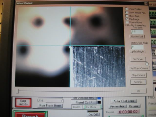

    This has always looked like a neat idea but after seeing the article in the latest Digital machinist I decided to make one this weekend. I picked up a cheap logitech webcam for under 30$ and dug out some scrap hunks of aluminum. Made a new housing with setscrew adjusters to dial it into the spindle centerline.
    Well it works pretty darn good. It can be used for measuring, inspection and edge and corner finding,punch mark location and bore location.
    If the surface edge is sharp I found it reliable to under .0005" finding both edges of a square corner. Within a .001" on a bore. The sharper the surface edge the more accurate it is. Bevels on the edges make it more difficult but you can still get very close. Probably can find a lot of uses for it. Punch marks look like craters.
    Steve

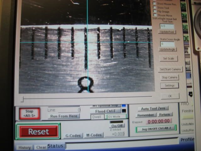

    these are 64th graduations. I was able to measure the graduation marks at .006" with the camera.
    This is a #80 drillbit. It is .0135" in diameter.
    Picking up a corner edge. This is Starret precision ground flat stock. Surface finish doesn't look all the great when magnified.

        Nice job Steve. Which software are you using?

            Mach3 has a video window for a camera and you can also use this software as a stand alone and as of right now it is free-
            Yes, the camera focuses that close on it's own. I am not using any other lens with it. It will focus to just about a 1/8" distance. This one has a manual focus ring. Just a cheap webcam from the local dept store.

              how did you align the camera with the spindle, and are cross hairs in the software?

                    The cross hairs are part of the software. Centrecam also lets you make circles. So you can locate in on any sized hole in your work.
                    To adjust the camera I just rotate the camera in the spindle while focusing on a cross mark on the table. Adjust the setscrews just as you would a 4 jaw chuck.

                    I had a square edge on the table. I located a corner edge with the camera using the cross hairs. I removed the camera and installed a ground .375" pin in a collet. I moved the table exactly .1875" in each direction and the pin did not contact the part. However I could not fit a .0005" shim between the part and pin on either edge. That's pretty darn good edge finding IMHO without ever physically touching off the edges.
