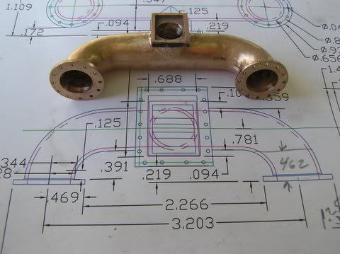

    Lets start off by saying that I tried to cast the pipe 17 times, and each time was a failure, which I will not review here, other than to say it was mostly a porosity problem. Determined to make it from scratch, I came up with what I believe is an original way of making elbows, without using any Special Tooling like rotary table, indexers, or CNC , and no casting !.
    In this photo you see the #17 Pipe which failed when it was polished.
    It is sitting on the print that shows dimensions and form. Please note,that to cast it, I had to forego the throttle box unit which was an integral part of the original engines' Steam Inlet Pipe. Something I was not happy with,
    to say the least

    I take the drawing you saw in photo #1 and make several full size ones, and cut them out square to match the castings edges (!) and glue them to the casting sides --accurately ! I take a spare print and position it on the far vice jaw and determine the angle I want from it, and the depth and length of my cut by eyeballing the cutter and setting stops. then I place the real block in the exact same spot and do my undercutting. If you look at the cut, you can see about 1/4" left in the slot that is the bottom of the pipe
