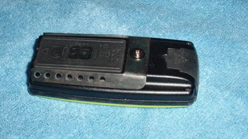

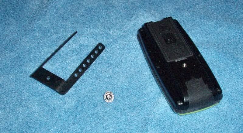

    I recently got a new GPS, a Garmin Gecko. I really like it except that it needed a better method of attaching a lanyard so I could carry it around my neck. I wanted something that wasn't prone to twisting, and would carry the receiver with the antenna exposed so I could get an accurate trace of my path as I hike. I also wanted to be able to access the battery compartment without removing the lanyard adaptor (a flaw with the factory accessory).
    The idea had been brewing in the back of my mind for awhile. Today I decided to go for it. I'm fairly pleased with the result:
    Here it is attached to the receiver:

                  Thanks for the kind words, folks!
                  It is intended to carry it upside down. My experience has been that upside-down works ok, as long as the unit is facing away from my body.
                  I thought about the phone clip solution, but I keep breaking the clips on my phone, so I didn't want to trust my GPS to it when I go bushwhacking. I think this should hold up pretty well, and being aluminum it'll bend rather than break.
                  I haven't tried geocaching, but it sounds like it could be fun.
                  This was a hand-tool project, by the way, and one that's in reach of anyone who cares to take the time. The shape was cut out with a hacksaw and filed smooth. I drilled the holes with my milling machine (it was handy ) but it could be done with an eggbeater hand drill. The material is 1/16" aluminum sheet from the K&S display at the hobby shop, and it was finished with Birchwood Casey Aluminum Black.

                      The thing that catches my eye and makes it look really "pro" is the neat radius on the inside corners. Did you use predrilled holes in those corners, or was it all careful hand work with the saw and files?
                      Roger
                        I drilled 1/8" holes at the inside corners (well, 1/16" inside the planned corner point). Then I sawed just inside the line and cleaned up with a file.
                        I didn't do the radiused corners so much for looks as for durability, it reduces the chance of stress cracks forming. But thanks for the compliment!
