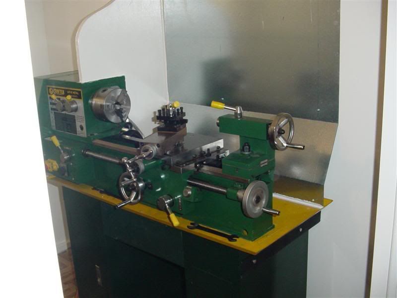

    Well, the lathe has a home of its own!! I have been drywalling, painting, and wiring for the last 3 weeks, and I'm done!!! I got up early this morning and hooked up all the electrical wires into the main panel, and that was the last thing I had to do. It is very difficult to get a decent picture in the lathe toom because of all the light coming in through the window, but as you can see I have added a galvanized steel backsplash to protect the drywall behind the lathe, and a chip guard behind the chuck just to keep chips from flying in that direction. All the walls and ceiling are painted with an oil based enamel paint (latex based paint soaks up splashed oil or cutting fluid like a friggin sponge). The room is virtually air tight when the door is closed, with rubber gasketing all around the door to keep the lathe smell out of my office. I am very pleased with how it turned out---Now hopefully I can get back to my REAL job---the one that pays money!!!

          Excellent idea with that splash guard. I should put one on mine but I am afraid it is far too late. At least the marks on the wall, floor, ceiling etc serve as a hazard zone indicator...

            That looks real nice. I have many times argued with myself about making a splash guard but I never do. I see a need but in the end I don't. I think I spend about 1/3 of my time on the back side of the lathe for cleaning and set up purposes. I have it set up right dab smack in the middle of the workshop with lots of walking room all round.
            I notice you also have a board across the top of the spindle. Would never work for me. I have a mag light mounted there plus a spot for my chuck key and quick change tool holders and a cutting oil bottle and and.... Just the way I work and everyone has different habits.
            I think if you took a census you would find that to have a splash guard or not the group is probably split with a slight favour to the having side. I could be wrong (and often am). I just like lots of room all round the tools. Different strokes for different folks.
            Not trying to take anything away from what you have done as it is well done and something that will prove handy.

              I'd already been thinking about putting a splashguard behind my Logan, as I kept having to sweep piles of chips out of there.
              I finally did it after parting half a dozen thick washer/spacers, and having five of them pitch themselves right down that slot.

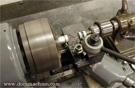

              'Course, the next time I had to part like that, I used the WD-40 straw trick that somebody had in either HSM magazine or maybe here on the board:
              And, I'll be putting a similar guard behind my new Sheldon later this week- I just spent half an hour sweeping about sixteen pounds of swarf out from behind it.
              Most of the time I've seen someone with an un-splash-guarded machine (and one other than a modern machine that comes with at least a partial sheetmetal enclosure, like Grizzlies and Jets) they have it somewhere other than next to a wall, so inaccessible swarf isn't much of an issue.

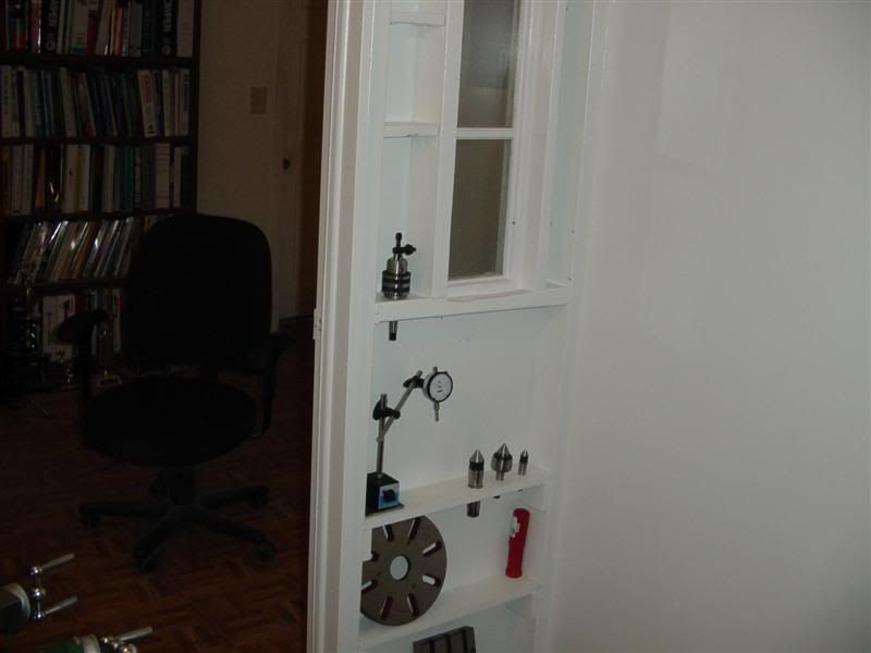

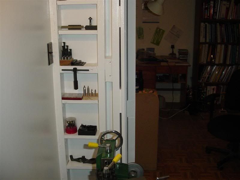

                  GrahamC---when I built the room for the lathe, I drywalled the side that shows (it is off my engineering office), and on the side where the lathe is I intentionally didn't drywall it.---Makes a perfect spot to build shelves for all my lathe related "junk". The concept of having a lathe out in the middle of the room is appealing, but I was trying to squeeze space out of an area that is included in my central heating. The main basement of my house is carpeted and finished, so I squeezed a 6 foot by 7 foot space of the end of my office to make the lathe room---at least the floor is only peel and stick tile over concrete floor.
