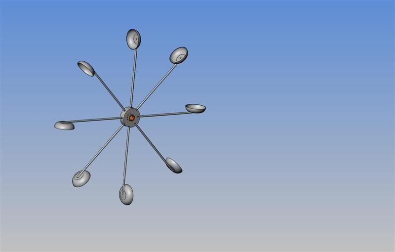

    Not one that does anything---just something that will go around in the little stream behind my house and amuse my grand daughter. I am tentatively thinking of a 3" or 4" diameter aluminum hub, 1" thick with a 3/4" i.d. oilite bronze bushing pressed into it for a bearing. I will use 1/4" diameter aluminum round rod arms x 12" long, with a 1" long thread on one end and will drill and tap the hub 8 places at 45 degrees. Not sure yet what I will use for the paddles---I have no welding apparatus for aluminum here, so whatever I use they will have to bolt or rivet to the ends of the arms. I think I seen some aluminum egg poaching cups at the cookware store that were about 3" diameter x 3/4" deep.---I may use 8 of them, and flatten the ends of the 1/4" aluminum rods on my anvil so that I can drill them for a 1/8" aluminum pop rivet thru the center of the egg poaching cups.

      Might think about a hoop around the outside of your spokes which the cups/paddles attach to. 1/4" aluminum is pretty flabby. A little bit of rain might bend things up pretty bad.

        Its going to have a "fixed" shaft. There will be plenty of action to see just having the wheel go around. I grew up in northern Ontario, and our house was beside a stream. I used to build waterwheels all the time when I was a kid. Sometimes I would run a live shaft with a crank on the end and a trip wire running to a cow bell. ----That was really great untill you tried to go to sleep at night!!!!!!!!
          Just for another thought - have you seen the tesla turbines? Alot more material and work for your application but they are pretty neat.
          If it rains hard enough to bend 1/4" diameter aluminum rod, I'll probably have other things to worry about!!!

              So for more action and fun to watch stuff, put a line of small cups around the outside. Set them so they scoop up some water, lift it, and pour out to let it run down a trough and splash back in.

                  I would build it from wood. A lot cheaper and more authentic looking. Also, as you are in Ontario, it won't be as big a deal if the Fish and Wildlife officer catches wind of it and tells you to take it out of the creek.

                    You might hunt down a spindle & hub from a small car or lawn mower. Has nice bearings & seals and saves on some engineering time...

                        Well actually----I'm looking for a project to use my new lathe on. Wood gets waterlogged, and bearings rust and seize up. I'm thinking all aluminum, with an oilite bronze bushing, and a stainless steel shaft. There is a peice of 3" galvanized pipe setting vertically on one side of the stream already, from a left over bridge abutment (wooden bridge that rotted away), so I will probably make a clamp collar from aluminum with a stainless shaft about 6" long bolted to it. this can be clamped to the peice of pipe.---The wheel will rotate on that.
