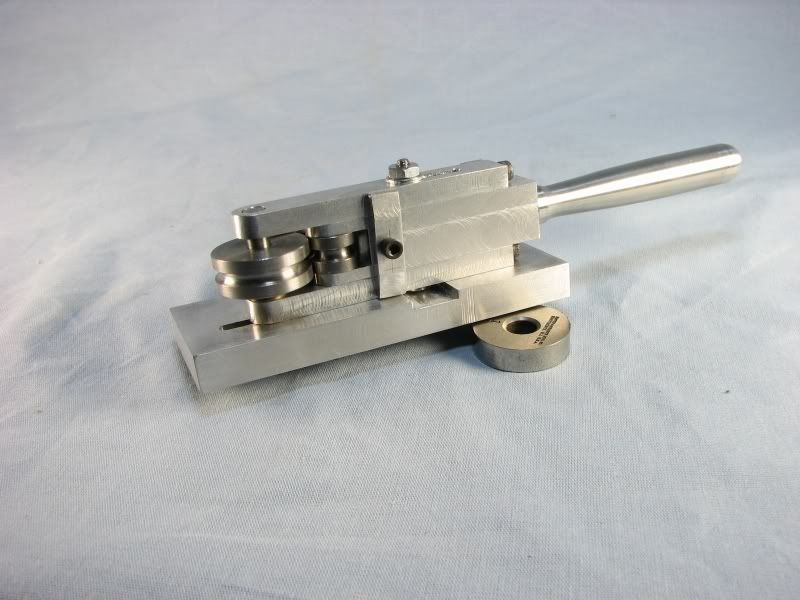

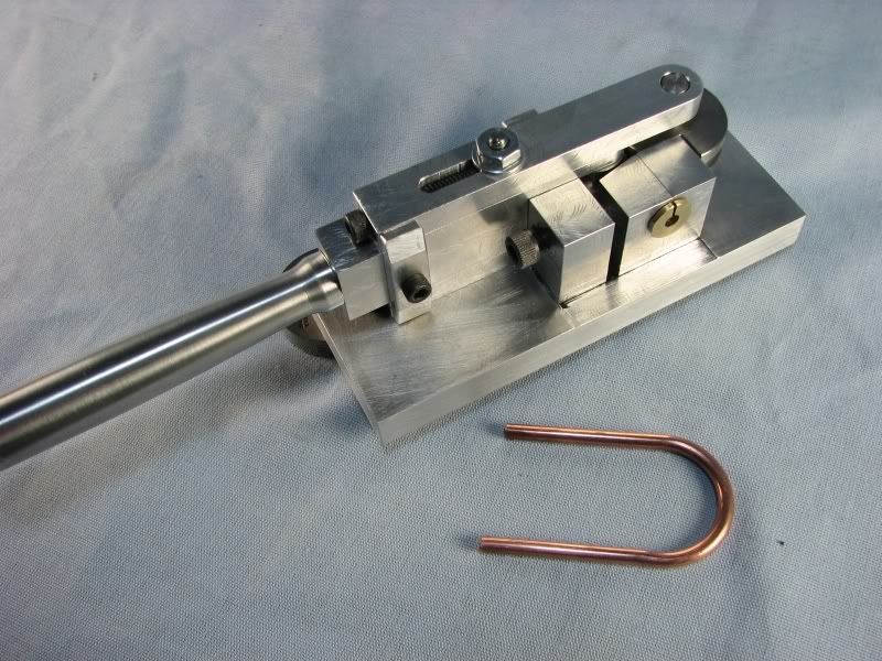

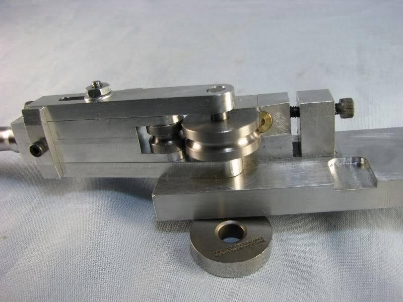

    Awhile back I posted some threads on building the crank for my scratch Holt model engine. I have the engine complete and am working on the fuel and cooling system. I got down to needing some 1/8 tubing bent for the fuel supply and from past experience knew that it could become quite ugly trying to bend it by hand so I figured it was time to create yet another tool for my vast modeling tool arsenal. I started with an article from Model Engineer by C. Horace Clarke. His was O.K. but didn't allow enough adjustment for different radius bends so I set about reengineering it and making a set of drawings. That finished, I built one and made my first bend. I was pleasantly surprised how easily the tool worked and how smooth the bend turned out. I am posting some pictures of the tool. The micrometer standard in the picture is 1 inch diameter so that gives you an idea of the size. The copper tubing has a .47 radius. It might be able to bend something smaller but this is what I needed for right now.

            Very nice! I can't tell from the picture but did the tube flatten any thru the bend?
              Thanks gentlemen,
              JBL37, I turned the handle separately. It has a 1/4-28 thread on the end of it. Mike, no the tube is completely round, not flat whatsoever, at least not perceptible.

                              For use on different size tubing, would it be necessary to make a new
                              set of "dies" and a guide (the brass peice)? It looks almost too nice
                              to be a tool, more a work of art. :-)
