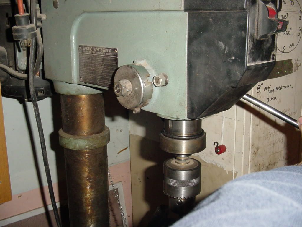

    Bit by bit, I am using my lathe to upgrade a lot of my existing machinery. So far I have made a new main gear hub for my home built reciprocating hacksaw (the main gear is 14" diameter and had a terrible wobble to it, which was the result of not having access to a lathe when the saw was built 35 year ago), and I have added adjustability to the table of my home made vertical belt sander. Now it is time to improve/modify some of my purchased machinery. I have a Delta Drill press (floor model) which is about 20 years old. It has been a great machine, but come from the factory with no depth stop on it. I took a close look at it this morning, and I see how an adjustable depth stop can be made fairly easily. I was just wondering if anyone here on the forum has ever made their own drill press depth stop, and if they have any pictures of what they done.---Brian

    This is a picture of the drill press with the spindle advanced about 1". The largest diameter above the chuck does not rotate when the drill press is running.---It is 2.59" diameter x 0.79" thick. I believe a peice made to clamp around it, with an extended nose out to one side could be made from 3/4" aluminum plate, and a peice of threaded rod attached to it (as per 3D cad model). I would have to make a bracket that attached to the cast portion above it, on the main frame to let the threaded rod pass thru a clearance hole, and add a couple of lock nuts. The only possible problem I see is drilling and tapping the casting for a couple of 1/4-20 screws to hold the bracket in place.

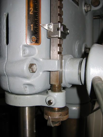

      This fairly slick device is on my Atlas DP from 1952.....
      There are fixed increments, and a calibrated adjustment within each fixed increment. it attaches just as you propose.
      (BTW, it came on it stock, all I have done is re-make the slider, which was of course zamac, despite this being an "industrial" machine.)
