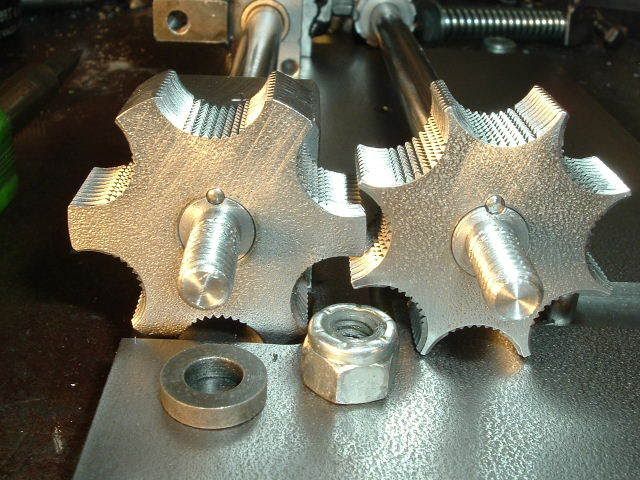

    In a search I found one mention of doing this, I was just wondering if this is mechanically sound, relatively speaking. The shaft is 3/8", the threaded stud is 1/4-20 and the key is 3/32" x 3/8", those sprocket looking things are 1/2" thick . While there will be torque its not much. I drilled these using a jig and drill guide , I thought for sure the holes would be big enough for a dowel pin which is usually the case unless I drill a pilot hole first but it was too snug, luckily I had some needle roller bearings that fit.
    Its fine, even square keys fail.
    I would not recommend doing that on a big ol tractor PTO though..
      Scotch key
      Yep. AKA "scotch key" and has been around - and very effective almost for-ever. Some were/are drilled/reamed and others ("Scotch") were just drilled and tapped. "Roll-pins" work pretty well too. The nut or washer on the thread will hold the key in against any tendency to "walk" or "work" out.
      It beats the hell out of making internal and external key-ways!!!

          A square key transmits energy tangentially to the next component. Round keys exert a force away from the center to the next component. It probably won't matter right away if the key is square or round. I do wonder what would happen with an oscillating shaft over time, though.

              I could be wrong, but I believe I read that round keys are stronger because they avoid the stress risers that the square key slots create in both the shaft and the wheel/knob at the corners. As for the keys themselves, size for size, the shear strength should be close to the same.

                If a square key is "male" to both the "driver" and "driven" the square key can develop a "rocking" motion in its "slot/s" (keyways) if the shaft/coupling is oscillating. A Woodruff key is often better because of its depth of embedment (usually) in the "shaft". Multiple keys are often better than one. The optimum perhaps is a spline with perhaps the "involute" spline/d shaft or its derivatives being best and its mating (usually) "broached" mating (female) coupling/gear etc.
                As said, a round key is surprisingly adequate. They are often designed/meant as a "weak link" (mechanical "fuse"?) to ensure shearing-off before the gear train or what ever is over-loaded.
                  Works very good. Use it (among other things) to repair a stripped threaded hole with a threaded plug of a larger size and a round key to hold the threaded plug in place.

                      Thanks for the info guys, I thought it would work but hadn't seen anything other than the one brief mention. I managed to get a dowel pin in it, its nice and tight just difficult to work with such a small pin.

                      LOL that exactly what I was trying to avoid, plus I have to make sure its indexed to the ratchet mechanism on the other end.
