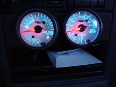

    Im getting ready for the second phase for the quest for better economy, Iv posted phase I and for the most part its essentially something within most everyones grasp, tire pressures, synthetic lubes and driving habits -- My progressive ratio throttle control is a nice help but not a must as if you pay attention you can still achieve great "metering" results. With phase I Iv taken a car thats rated 33mpg (highway) and have achieved over 50mpg's and that is in all actuality with a little mixed and slightly hilly driving, so im well into the 50's,
    Phase II will be much more involved and requires me to tap into my engines computer and overide certain situations, it differs from my first attempt in that now im entering an area where if i get too carried away I can cause detrimental damage to the power plant, My new gauges came in and right now im just getting used to where My engine has been "living" and how much elbow room I have to make improvements, I have found that I actually have much room for efficiency improvement but there is also much to consider in many situations -- and although i plan on having an economy "mode" for all driving conditions the gauges have shown me that I should make the best gains in a "controlled environment" -- this equates more to highway as it will allow me to dial in the perfect mix (well perfect for this phase)
    I believe I will break into the 60's but I dont know if I could do it with any mixed/hilly conditions, we shall see -- at the very least it should be interesting ( I am going to actually wax the car it as it hasnt been in years and also add a missing cowling/underbelly panel thats been missing)
    Here's a pic of my new little babies;

              Yes Carld i believe this is where im going to have to make the change, Iv ran a pair of wires from the ambient temp sensors connector to inside of the cab, had the sensor mounted directly in my heater/AC vent and ran through the entire range from burn your fingers hot to freeze them off -- I really could not detect any noticeable mixture or EGT change --- my idea of changing the TPS is out because it also controls FI shut off and other functions - coolant temp sensor manipulation is out of the question as this would not benefit and could go the opposite way depending on the computers design --- If i was the programmer I would want to lean till normal operating temp -- but -- if it surpassed then I would want to re-richen the brew for cooling - I dont like it - i want to leave it alone, I dont have an air-flow meter - I do have a map sensor BUT -- I cannot get an ohms reading on it, I dont know how it works.
              So far the OXY sensor makes the most sense, And it is the most dominant sensor BUT - my luck has it that I have to come up with more volts to trick the computer into thinking too-rich, it would have been nice just to install a variable resistor between and bog down the volts -- but now Iv got to add more and im not a electronics guy, One of the theorys im kicking around is installing another, by having two I can wire them parallel, at first this might not seem to make sense BUT - if I keep one down stream it will catch the rich/lean cycle from the computer at a slightly different time, perhaps with the help of diodes I can then take the best of both spikes and also the highest of the highest low, maybe I wouldnt even need diodes? Or use oxy sensor 2 to charge a small cap? then it will medium out the low on the other sensor? HMMMMMMMMMMM
              As you can see --- Its electronics and I dont have it together at all here and am open to any useful suggestions, please help me turn my engine into a pile of molten gooo
