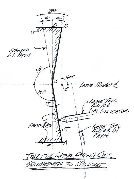

                            Paul A at Post# 12 at:
                            suggested using a lathe face-plate. I would agree with that if the face-plate was known to be very flat and neither concave not convex as the "out of flat" will or may introduce an error or (((180) - (cone included angle))/2) which will be a contributing error ("false positive/negative").
                            I have explained this previously but the sketch on this link should make it obvious.

                              Originally posted by Paul Alciatore
                              Place the faceplate on the lathe. Place the square against the faceplate. Run the DI along the edge of the square using the longitudal feed on the lathe.

                                Now I will deal with your comment on Paul's method in the lathe.
                                Originally Posted by Paul Alciatore
                                Place the faceplate on the lathe. Place the square against the faceplate. Run the DI along the edge of the square using the longitudinal feed on the lathe.
                                I dealt with that in terms of "flatness" (and implicit and inferred "square to the spindle"). "V"-ways are by their nature, self-aligning with minimum or no practical errors if straight and not worn laterally with respect to the lathe spindle. They they are so accurate and reliable is indicated - and proven - by their known accuracy in lathes and grinders - and do not need or use gibs or any other adjustments. The ball-races in my surface grinder are a variation and a case in point in that there are two "V"-ways with balls between them - a "straight ball-race". So, I'd accept the V-way set-up in preference to any or most others.
