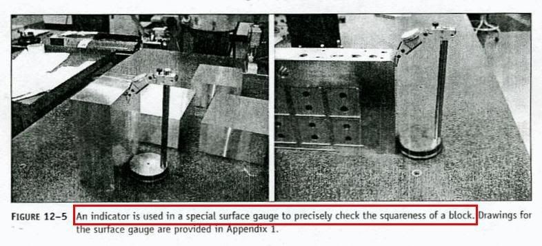

    Originally posted by John Garner
    Testing perpendicularity in the manner Forrest Addy describes is a common practice in metrology, but it's important to realize that the technique is totally blind to a difference in the diameters at the of the would-be-cylinder being tested at its "hard" and "indicator" contact points.
    as with the conventional cylinder square, the surface-gage-and-indicator won't find taper in the "square cylinder" object.
    Thanks John -- I've made that point several times in this thread:

    Alternative to a cylinder square
    Consider as an alternative to a conventional cylindrical square the variant commercialized by Hermann Schmidt, pictured on their website at https://www.hermannschmidt.com/produ...&idproduct=229
    Hermann Schmidt's picture makes the squareness-checking process self evident, but as with the conventional cylinder square, the surface-gage-and-indicator won't find taper in the "square cylinder" object.
    A roll-your-own "square cylinder square" should be fairly straight-forward, and the meaningful errors are constrained to a single plane . . . unlike a conventional cylindrical square that really needs to be measured and evaluated in both the "North / South" and "East / West" perpendicular planes.
    Of course, if you wanted to made a four-sided "square cylinder square" . . .
    John

  • lazlo
    replied
    Originally posted by Forrest Addy
    There's merit to Franks proposal. It strongly resembles the three surface solution to proving flatness
    The three plate solution solves this problem neatly in that the blue indications can be taken up on vellum and preserved.
    There's a big difference Forrest -- in the three plate method, the three plates start off way out of flatness, and through sucessive series of scraping and spotting, you gradually improve the flatness of all three.
    Frank's proposal is the equivalent of trying to determine the flatness of one of the original three plates by matching against the other plates, before all the scraping happens.
    If you get lucky, and they're all close, then you can probably get a reasonable measurement out of it.
    But if the wrist pins, or 3 plates, are way off, you won't be able to get a useful measurement.
    In any event, any further participation in this thread and I'm going to be criticized, so I'm signing off. I think Jay knows how to check his wrist pins.
