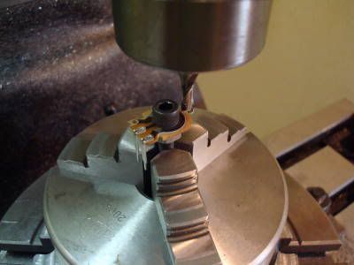

    I had to change the value's of a pot. --- great little unit with 37 detents - and two way on/off push switch built in, trouble is is this was the only one of its type at radio shack, its a 500k ohms and just started to get me into the range that I needed but not quite ---- I love my mill - never did I ever think of all the possibilities that I would end up using it for - God willing I'll never be without one...
    It was way cool to have the ohms meter right there on the mills table - take .005" off the radius of the pots resistance material and then measure the new reading - It took a couple of attempts but I got it to where I need it now.

          Mikem, Im a hack -- but, from my experience this is what I was dealing with -- I did go the route you suggested first, and it got me in my range - BUT, it then makes the pot about useless as it is no longer the "smallest valving" anotherwords - even just ramping onto the pot would put about everything onto the resistors back and then the rest of the pots travel was about useless -- Yes I needed a higher value pot, and I took the one I had that was 500k starting ohms and made it a 1750k starting ohms -- without effecting the full on position, Now i have the range of resistance I need -- all in the pot itself.

                  That is clever. I do have several thoughts on the process.
                  First, I would have tried to find a better quality part to start with. Radio Shack parts are the cheapest of the cheap. You may have to replace it soon.
                  Second, anyone comtemplating this should be aware that the power rating of the pot will be decreased with this kind of procedure. I doubt you will have any trouble with a 12 Volt system and your resistance which is close to 2 MegOhms (P=V^2/R), but smaller value pots or higher Voltages would need careful consideration.
                  Finally, I would clean it out very carefully as any dust from the machining could get in the way of the wiper and cause erratic operation.
