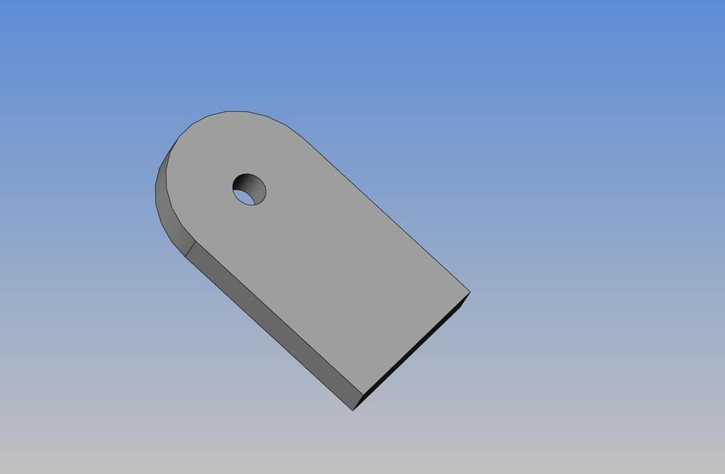

    Gentlemen--I spent the day milling out a main frame for a new model steam engine project, and it was a great success.--That is to say, I didn't cut off any fingers and didn't ruin the part!!! I started with a peice of 1" x 3.5" aluminum flatbar and actually ended up with a pretty swoopy looking part. Now my question---I want to mill a radius on one end. I do have a 1/2" diameter hole in the part I want to mill at what will be the center of the radius. My rotary table (which I have never used yet) has 3 T-slots on the top rotating part, and a hole for an MT2 tapered collet or spindle. My plan is to turn a peice of aluminum which will locate in the MT2 tapered hole inthe center---(not a tapered part, just a round one---I'm going for a locating device, thats all), and has a turned diameter extending above the top of the rotaty faceplate which will locate in the 1/2" hole in my part. I will attach the part to the T-slots in the top of the rotary table using T-bolts. I will attach the rotary table to the bed of my mill using the T-slots in the base of the rotary table.- I will locate the rotary table and part in a relationship to a 4 flute end mill, so that the side of the end mill is tangent to the side of the part to be milled. --Jeez, I hope this is making sense--Then, I should be able to turn the round handle on the side of the rotary table to make the top of the rotary table rotate through a 180 degree arc, thus cutting an arc around the end of the part, using the center of my 1/2" hole in the part as my centerpoint of radius. (the part I an cutting is 1/2" thick aluminum.) Do you understand me??? Am I going about this in the correct way???---Brian

              The operation was a success!!! The patient lived!!! It was a trick---the radius wasn't at the end, it was half way up the peice, but that is to hard to explain with text, and all the same rules apply. My rotary table works excellent, and I'm glad I spent the money to buy it. Here is a picture of my set up, and of the machined part. The round part with the red end is the locator I machined to go in the center of the rotary table faceplate. to locate in the 1/2" hole in the part.
