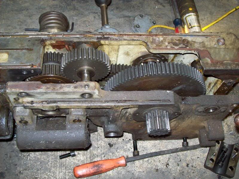

    I wish I could be more descriptive. There is a "jack shaft" which has two gears and idles between two bearings in the apron. One gear is within the apron and I'm going to refer to it as the bull gear. Then, on the outside of the apron, is the second gear. It is the pinion that engages the rack to move the carriage. That bull gear is driven either by the gear that is engaged by the auto-"lead" lever (to use Pacemaker descriptions) or by the gear on the handwheel shaft. That bull gear is held onto the shaft by a key and it is sheared in both of my Pacemakers!
    In my other thread I gave a description of removing the carriage and then removing the apron from the carriage. I'll pick up from there for repairing this key.

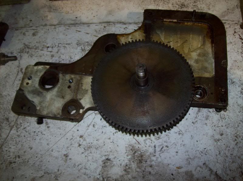

    On the front side of the apron there is a round cap that needs to be removed. A shaft with a nut and lock ring will be exposed. After bending the tab back, the nut must be removed. Then, the apron "cover" can be removed. Here is a picture of the cover being seperated from the apron. There are four, iirc, SHCS that need to be removed and then there are four dowels holding it in place. Then, the set screw (clearly visible in this photo) needs to be loosened. As long as the handwheel shaft is removed, there is nothing else preventing this cover from being removed. As it is removed, the bull gear, pinion, and "jack shaft" will come with it.
    Here is the cover once removed:
    Now, theoretically, you could remove that round cover, nut and lock ring on the front side and just tap the shaft out and then pull the gear out from between the apron and apron cover. In this case, though, after the key sheared it jammed up real good. In fact, I would never had noticed, except that I knew I had a sheared key somewhere in the other pacemaker so I decided, while this one was apart, to do some exploring. I thought I'd take it apart on this one as a "practice run" so I'd know what to do on the other.
    It turns out that the bull gear was stuck on there so hard that it took a 50 ton press to press the shaft free from the bull gear. I sweated bullets the whole time.

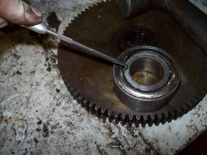

    First, though, I had to get the shaft free from the apron cover. I had to carefully tap the bearing out of the apron cover. I couldn't just hammer on the pinion gear, since all of that pounding would be transferred to the inner race of the bearing. I used a brass drift and carefully pounded on the outer race of the bearing. OOPS - not carefully enough! I bumped the shielding and crushed it in. There was already a section of the shielding that was damaged, so I wasn't the first.
    After freeing the shaft and then using the press to press the bearing off, I discovered the sheared key and damaged shaft. That would need to be repaired, but first I chose to address the bearing issue. (I was feeling like a real loser at this point since I didn't know there was anything wrong with the shaft. I was just satisfying curiosity when I damaged the bearing)
    I talked to ND, but they said they couldn't even match a bearing to the part number I gave them; it was too old! So I decided to see if I could repair it.
    Using a hammer and a scribe, I punched small holes and then bent the shield back up out of the race.
    The bearing is now useable. After opening up the shield and carefully reshaped it and did my best to close the holes back up. They are very small, not much bigger than a needle so it shouldn't matter too much. They weren't sealed bearings to start with, just shielded on this one side to keep swarf out.

                New Departure went out of business years (decades?) ago, but they're almost all standard bearings sizes. Get a bearing cross reference guide and buy some modern replacements (for a whole lot less than NOS New Departure bearings).
                    Actually, I think I've found more non-standard ND bearings than I care to remember. Lots of extended inner race bearings that appear to be unavailable now. Many time a spacer will solve that problem though.
                    Some of the common older Delta woodworking machines used ND bearings that are no longer readily available.
                      Yep - I measured the bearing and it was an odd-ball one. I can't remember now what the dimensions were, but it was a double row ball bearing. Maybe it was metric dimensions, who knows. Anyway, I couldn't find anything that was close but I didn't look particularly hard. I figured I try fixing it and see how that worked. If need be, I can replace the bearing in another few years when it fails. Its not too hard to get to. In fact, now that the key is fixed I can remove the bearing while the apron is still intact and installed on the carriage.
                      Thanks for those websites Weird - I'm sure they'll come in handy!
                      Thanks again AK - I wasn't sure my "bodged bearing" repair was an acceptable solution in the world of machinists! I am glad now that I tore it apart. I would've felt like I did a half-a** job otherwise.
                        ND made many types of specials and OEM speced bearings that don't interchange with anybody.Some of those can still be replaced with standard ball bearings,but spacers will have to be made and shoulders bored back and re-machined.
