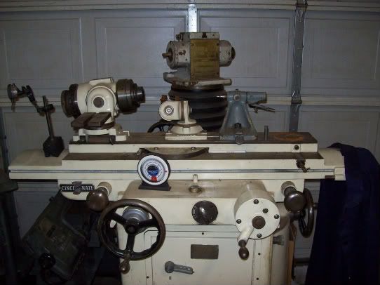

                  I've said it before, and I'll say it again - You want to sharpen End Mills, you're going to need 1 of these
                  Not only can you sharpen end mills but every thing else under the sun that needs a fine edge AND with the added benefit of small I.D. & O.D. grinding
