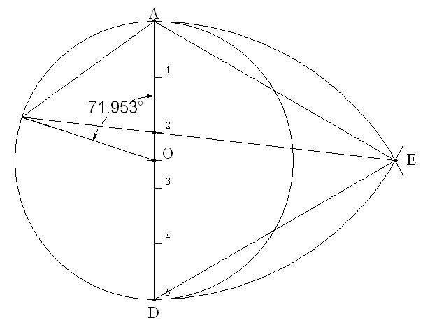

    I just came across this geometric solution to laying out bolt hole patterns on a circle. For any diameter circle AD divide the diameter into as many equal part as bolt holes needed. Then draw an arc intersection that has a radius of the diameter of the circle from A and D and labial this E. A,D,E form an equal lateral triangle with A,D as diameter of circle. Now draw a line from E throw the second equal point from A on the diameter to intersect with the far side of arc of the circle and labial this F. Now take dividers and set to length A,F. Use this length to work around circle to divide the circle evenly.
    Before looking for a mathmatical proof of this, I tried a few examples with my CAD program. It works for 3, 4, and 6 divisions but not for 5, or 12. It appears to be an approximation that is limited to some low count divisions.

                    My CAD is "set" to more than 6 digits. Five inch circle divided into five and it was off by about 0.002" per hole: total error at the end was about 0.010". Eight inch circle divided into eight and each hole is off by 0.013": total error about 0.104". Six inch circle divided into 12 and each hole was off by almost 0.025": total error about 0.300". I don't know.
                    Have you seen any proper mathematical proof of this method? Are you sure you did it properly in the CAD program? There are so many other ways that I wouldn't risk using this.
                        How is this done? If a marked ruler is used to measure then it isn't a geometric construction. Even if it is possible to then find the spacing on the circumference requires multiplying the diameter by pi which is impossible geometrically. It is equivalent to the problem of squaring the circle. It is also equivalent to the general case of trisecting an angle, also impossible except for certain special cases only. In particular, one cannot by euclidian construction create an equilateral triangle on a circle. See Morely's Trisector Theorem for the proof.

                              I thought the procedure was clear, but perhaps there is some confusion. Here is the drawing of the way I have been doing it.
                              This is an attempt to divide the circle by five. The angle should be 72.00000 degrees. All CAD constructions here were done with the complete precision of the program. It is accurate to well over six places. Points were selected with end point or intersection modifiers to prevent false selections. The circle was drawn as 10 inches in diameter and the five divisions were taken from the grid. As you can see, the procedure failed.
                              It is obvious that it will work for two and four divisions. It seems to work for three. All others I have tried have failed.
                              If I have not follwed the directions correctly, please let me know.
