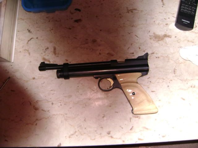

    well after 3 days of messing around my first breech with a matching muzzle brake is mounted and ready to rock and works great. it still need some polishing but then again i might leave it alone not sure yet but its my first one and iam loving it ill never buy from crosman again ye ha!!!! I also milled the slot for hte rear site and i made a site pin for the brake as well..

      What is is mounted on? Did you make the barrel too or was that part of the donor to start with?
      Looks real nice!
      mark61
        hi there the gun is a crosman 2240 pistol i make alot mod parts for this gun and a few other like the 2289 1377 and so on all really cool and modable airguns.
        i do alot of barrel chops as well take 14 or a 24 and custom cut recrown stuf like that my wife makes the grips for these guns as well , i used to untill i got my lathe and hten no more now i got my lathe and a mill so even more i keep to my metal and she does the wood stuff for the guns.
        one of these days iam going to design and build my own airguns from scratch,
        my next project is to make a paint ball adapter for this model of airgun if it works then it will give yet another option for this gun for amo that can be used in it...
        i do alot more then just airgun stuff to on my equipment , but lately its been airguns and getting this breech and muzzle brake made our moto is the plastic must go
