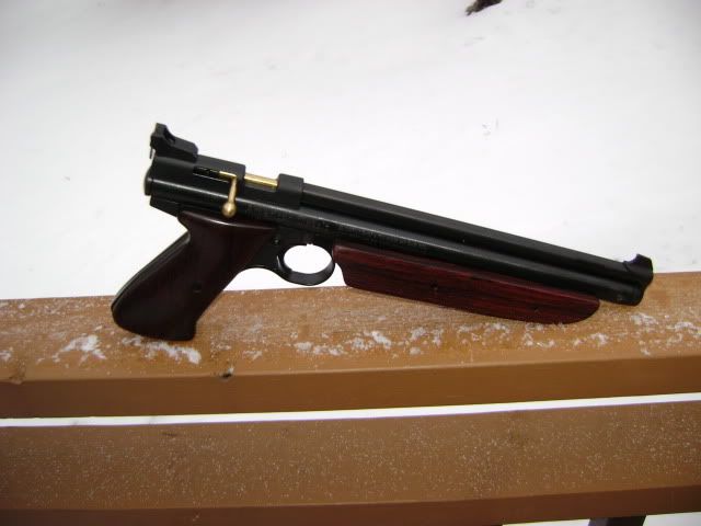

    ok the tool in the pics is for working on crosman airgun for taking apart the piston assembly on the crosman 130 140 annd many other crosman pistols and rifles , tomorow iam going to be making a reassembly tool for the pistol and rifle version piston assemblys...
    the block is some sort of steel not sure what.... gota it form a friend of mine forgot to ask , the rest is all stainless steel parts i made on the lathe...
    you should show pix;s of what it does when being used. . . otherwise its difficult to understand what you are trying to do with it. . . .
