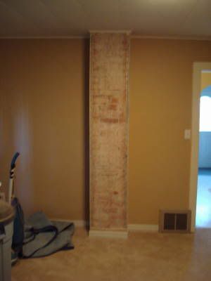

    First thing was to chip away all the plaster that was covering my chimney in the "dead zone" (thats what I used to call this room as it really was just kinda a room between all the other rooms)
    I was glad to see the chimney exposed and not all hacked up with past pipe holes in it --- as a matter of fact it was a virgin on this side...

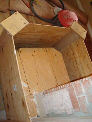

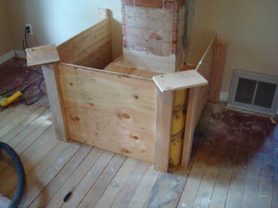

    Next up was building a form for the cement that I was going to build the base from,
    I ended up with about 4 1/2" thickness all around and the 690 lb base also has $50.00 worth of Acryl 60 in it plus re-bar, its going nowhere, acryl 60 is a concrete fortifier that is dynomite...

                              Tiptop those are indeed 90 degree's of a sona tube , what you cant see in the pics is I took the time to take one layer of plywood off for 1/2" --- it was the perfect depth and the same thickness of the sona tube, the sona tube was then fit into this area and screwed to the remaining layers of plywood --- Even though I knew I was going to apply a slurry coat after It gave me a near seamless finish to do it too...
