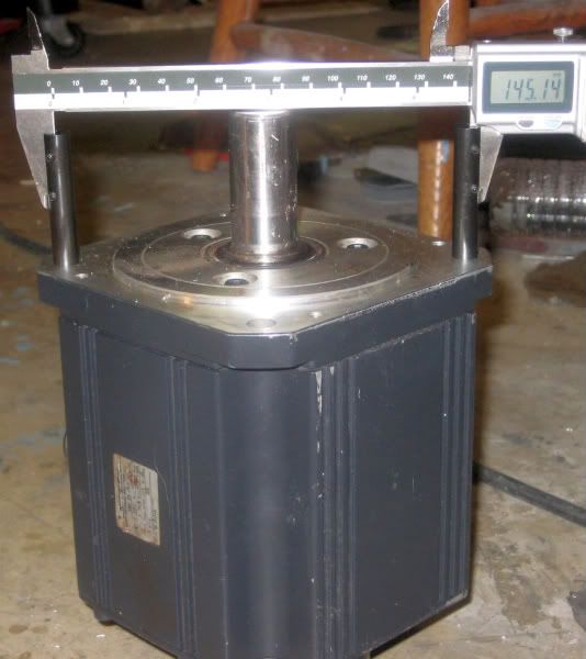

    In the thread here I posted some research and calculations I did for retrofitting a Bridgeport J-Head with a 1.5 KW (~2 HP) Mitsubishi AC brushless servo drive:
    Poly-V drive calculations for Bridgeport drive pulley

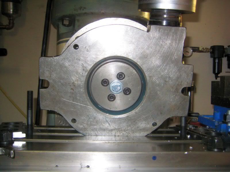

    Most AC brushless servos have a Metric mounting pattern, with a square face and a round inset. Since I needed to mill mounting tabs into the plate, this all had to be done with the rotab -- fun exercise. I finally got some time in the shop this afternoon and was able to finish-up the servo plate, and thought you guys might be interested in a pictorial build log:
    I started with a 3/4" piece of 6061, and band-sawed it to approximately 10.3" (the OD of the Bridgeport motor plate is 10.25"). I scribed the approximate center of the sawn plate, and drilled a 1" hole (the servo has a 24 mm shaft). So how do you mount a 10" round plate on an 8" rotab with only a single hole? My solution was to take a cheap Chinese MT-3 threaded arbor, saw off the tang, clean it up on the lathe, and then drill and tap the arbor for a 3/8-24 drawbar. Then you put the oversized plate on the rotab, drop the MT3 adapter through, and draw it in with a 3/8" bolt from under the rotab. The MT3 taper centers the plate as you tighten the drawbar:
    With the plate centered, the next step was the mill the circular depression. These are all action shots by the way (tool spinning). I just grab my Wife's camera and snap as I go -- she complains about me getting cutting oil on the camera...
    After I milled the circular pocket and the square motor mounting face, I dropped the 8 mm mounting holes. Then I needed to clean-up underneath the MT3 arbor mount. So I made some goofy 1/2-13 to 8 mm threaded studs, and mounted the plate through the motor mount holes. This meant that I needed to re-center the plate.
    So out comes the Blake Co-Axial indicator, first to center the hole in the rotab, and then again to center the hole in the servo plate on the rotab. The next several steps were going to require a lot of tool changes, and swapping the Blake in and out, so I switched to an R8->ER-40 collet chuck:
    We were discussing how much the ER chucks overhang, you can see that here, where I'm cleaning up the flash that was under the MT3 arbor:
    One of the really nice things about these ER speed collets is that you can have multiple collet nuts on deck, so swapping tools is really fast. These are two other ER-40 collet nuts with the collets installed, in addition to the one on the spindle:

      After checking that the servo motor fits the two pockets and the hole pattern correctly , it's time to cut the tabs. The normal Bridgeport motor plate has a 1/2" swivel bolt on one end, and a 2" radial slot on the opposite end to set the belt tension.
      The easiest way I found to do this on the rotab was to calculate the radial section of the tabs starting at the bottom left, and feeding clockwise so I wasn't climb milling. In other words, the bigger tab needs to be 2.85", so you calculate how many degrees of rotab travel that is: 10.25" OD * Pi = 32.2" circumference = 0.0895 inches per degree of rotab travel. So the top tab is 31.8°, half of that is 15.9°, subtracted from a 90° arc is 74.1° of rotab travel to cut the tab. Repeat for the bottom tab comes up with 77.4°.
      So starting at the bottom left of the smaller tab, you need to travel 77.4 + 74.1 = 151.5° to cut the left tab:

        Finally, the Bridgeport bolt holes are on a 9.2" circle, so drill the half inch pivot hole (I blued it for peace of mind, but the hole was located with the rotab), and then, to insure alignment, I chain drilled the 2" long radial bolt slot on the opposite tab:
        Then I switched to a 1/2" slot drill to clean it up:
        I've got some cosmetic cleanup to do (chamfer the edges and bolt holes), and hopefully I'll have my first live test with the servo mounted on the Bridgeport tomorrow.

                            The motor is a Mitsubishi HR-SF152, which is a medium inertia, 1.5 Kw AC brushless servo with a 16,384 pulse per revolution absolute encoder. I'm driving the servo with a Mits MR-J2-200A (2 KW) microprocessor-controlled servo controller. This controller does constant-torque, constant-velocity, and position control.
                            The servo inertia is important: servos come in light, medium, and (rarely) heavy rotor inertia. You want to match the servo inertia to the mass of what you're going to be spinning. So on a lightweight axis controller where the servo needs high agility, you want a light rotor intertia.
                            But for a machine tool, where you're going to be turning heavy loads, you want a medium or high inertia. Unfortunately, the price of the servo goes up exponentially with the rotor inertia. but you know how Ebay is: you can find all kinds of amazing deals...
