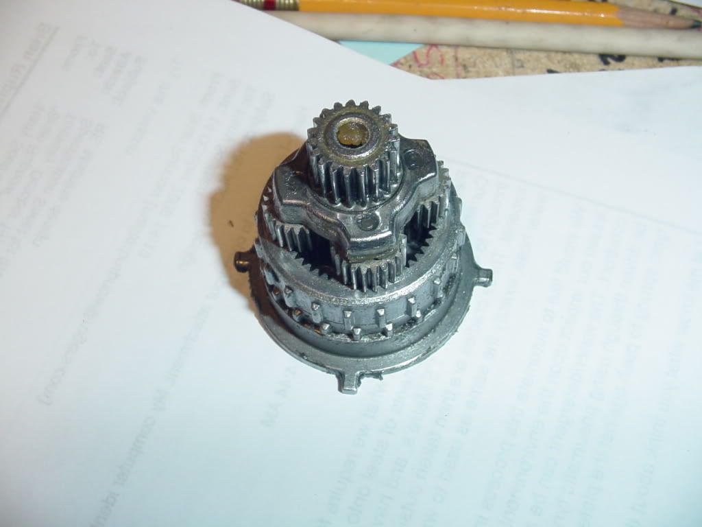

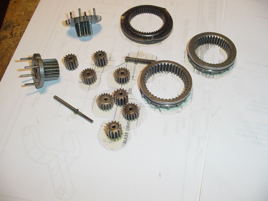

    I have recently been on a quest for gears to use on my models. This is something that I didn't know about. Pretty well all battery powered powertools have a whole whack of gears in them, and they are all excellent sizes for use in model engines. ALL of the disassembled gears in the attached picture came out of ONE power drill. They combine into one nest of planetary gears, similar to the assembled stack that I have shown. I went over and did a little creative begging at the local tool repair shop, and he gave me a whole basket full of these things, just for asking---they were destined for the garbage pickup.---Brian
    Yep, And the better ones will handle up to around 1hp! The robotics guys have been using these planetary sets for a while now.
