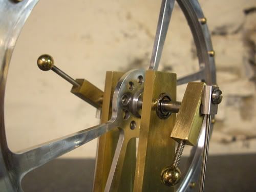

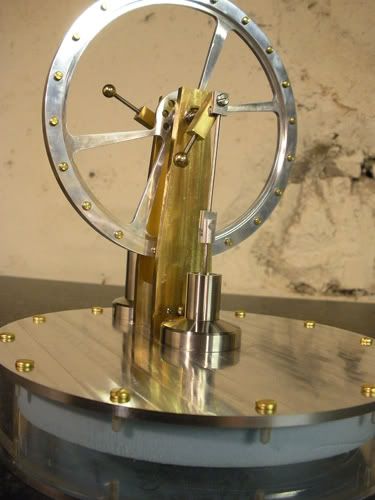

    Made this as a Christmas present for my dad. I bought a set of plans from Jerry Howell a while back but given time and material constraints, I modified them heavily. I kept most of the critical dimensions, but that is about it. Took about 75 hours to make, most of which was getting the scrap stock I had lying around into usable shape. All of the moving joints have ball bearings to keep friction to a minimum. It doesn't run on as quite as low a temp differential as I would like, but it is the first one I built.
    Sorry there are no construction pics, I got the camera for christmas - after I finished the engine, of course.
    Here's a hyperlink to a movie of it running. Its a large file, >30mb, so woe unto those with dialup

    Nice job on the miser. I especially like the adjustable counterweights.
      Is that a Sterling engine? What's the diameter on the flywheel?
        Yes, its a stirling. the flywheel is 4.75 inches in diameter. It looked a little light to me, so while it was still on the rotab I drilled holes in the rim and pressed in those brass pins. whether or not it made a difference, who knows.
        I made a wooden base for it over the weekend with a couple of 4w nightlight bulbs in it as a heat source. Spoke with dad at lunch today, and he says its still running, so that's good.
          Nice adaptation of the basic design!
