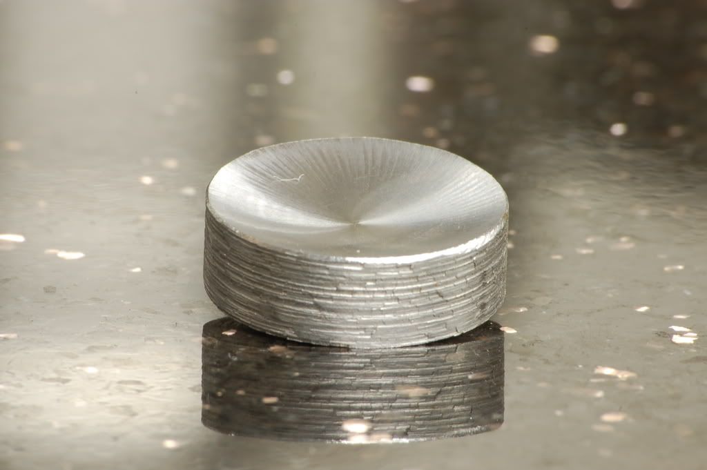

                      Evening All,
                      Ive been pondering on this, and after a little digging about looking into methods of making hemispheres I found a thread here showing how to do it on a mill.
                      So I knocked up a seat to fit one of my daughters rubber balls:
                      Ignore the turned finish, it was a scrap offcut of mystery metal, and was like that when I started.
                      Looks like the seat part *should* be possible.
                      Of course they'll need to be cut (or at least finished) in situ on the end of the bar, as the glue will have set then...
                      Dave
                      Just south of Sudspumpwater UK
