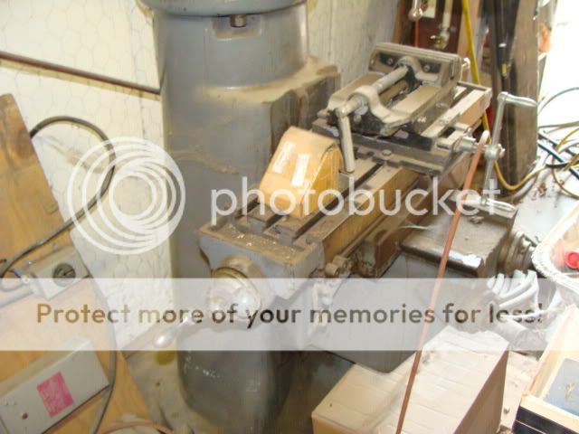

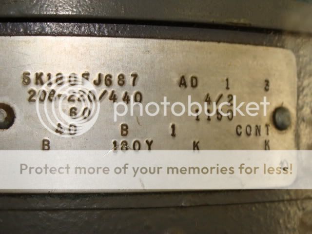

    I am going to purchase a mill. I am looking at the Grizzly G4048 or a friend has an older Millrite sitting in his shop that he will sell me for $750. The Millrite seems to be in good condition. The spindle bearing are a little loose, but smooth. The backlash is minimal, but I have not measured it. The Millrite has a 1 hp. 3ph motor so I will needed a phase converter or find a way to change the motor to a single phase.
    I mostly do small jobs and some gunsmithing. I know that I will have to wait for the Grizzly, but it is new and the Millrite is fairly old and I am sure it will need some work.

        You don't need a phase converter...a low cost VFD will run that mill and up the bells and whistles at the same time.

          Like Torker said, spring for a $150 VFD, and not only can you run the 3ph as-is, but you'll get near-infinite speed control as well.

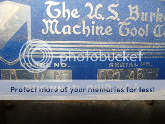

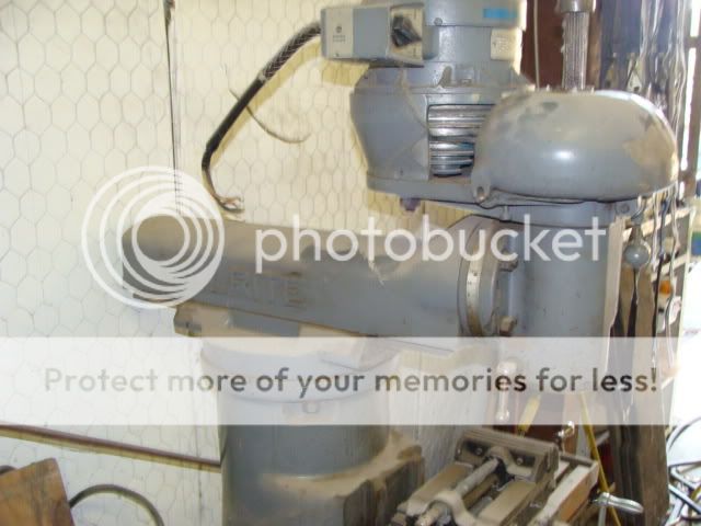

            OK, I think you have convinced me to go with the Millrite. I posted some pic's . Anyone know were I can find parts if I need them or books?

                            The Millrite is a good solid mill, about 2/3 the size of a Bridgeport. I would choose one in a heartbeat over an import unless the size were a factor. I have a slightly smaller Rockwell and it handles most of my needs for amateur gunsmithing. Table travel is limited for full length barrel profiling, but that is about the only drawback I can think of.
                            Tooling a mill or other machine tool can run as much as the initial purchase of the machine. This should be considered when establishing a budget. The Millrite came with several different spindles, and you should check the collet it uses. They came with B&S taper, MT, R8 & 30 taper. All are good, some better and easier and cheaper to acquire.
                            Millrite was manufactured for many years under several names. It was Burke, US Burke, Millrite, Powermatic and maybe some others I don't remember. They are a simple machine, and most repairs can be accomplished with the usual shop tools. The company is still in business, and some support is still available. I can't recall the name, maybe someone else can chime in with that information.
