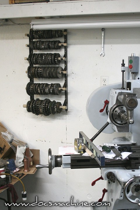

    I have been struggling to try and find a decent way to store all these cutter wheels for my horizontal mill. The usual issues: They need to be accessible, but not in the way, they need to be open enough I can find the one I want but not so "loose" they take up a lot of space, and I don't want to spend half a year making a thousand little drawers or boxes or racks.
    So I've tried two ideas recently. One, a simple welded rack and dowels:
    Not bad, and nice and dense. There's some 300 cutters there. The problem is, that lets the cutters bang against each other, which is especially bad for anything with side-cutting teeth. And to get at a cutter- especially one towards the middle- there's a great deal of handling, which means more banging and more wear.
    Probably won't be too bad for just slitting and slotting saws (no side teeth) or slabbing cutters (only have one so far) but by no means an ideal solution in general. Gets 'em up off the floor, though. I have over a thousand of these things, and have no place to put them.
    The second idea was to emulate a commercial CD storage rack- made of wire- by slotting a section of aluminum channel extrusion...
    To make this small rack that holds fifty-eight small slitting saws:
    Somewhat better, in that they're not allowed to bang against each other, and are much more accessible. But a pain to mill, as I don't have enough Y travel or a long enough arbor setup to be able to do even just a foot of channel without having to reset at least twice.
    The latter style, optionally, can also sit on a table/workbench, possibly with a nice routered oak base, or sit in a deep drawer and act as dividers.
    I'm not entirely happy with either method just yet, but I'm still pondering options. Any other ideas or suggestions? Again, I have over a thousand cutters- I can't just hang 'em all on a pegboard.

    That really looks nice Doc. Organized and the edges protected, and you can even find the one you need easily. The way that I have almost always seen them stored is thrown in a old 5 gallon bucket filled about half way with preservative water. And then they wonder why nobody wants to buy them at the estate/going out of business sale.

      No seriously Doc, you will find that a lot of these won't get used, you will have 'favourites' and stick to using these.
      In the last photo, 3 racks up from the bottom, two cutters in from the right is what looks like a 6" x 3/4" straight tooth side and face cutter. These take a tremendous amount of power to run and are very hard on a light or even medium machine, that big one, second rack up in the middle with helical teeth will cut smoother, use less power and get more use.
      Perhaps racking them larger straight cutters in the middle [ less use ? ] and smaller, thinner helical's to the outsides may stop a bit of sorting ?
      Stiff cardboard disks in between will help.

          Drawer with pegboard in bottom, and dowels sticking up. The pegboard holds the dowels and provides some structure to the arrangement
          Plain cutters of all kinds (gear cutters, ordinary slitting saws, plain milling cutters, convex and concave cutters, etc) stack directly with no clashing, and a disk of cardboard keeps side-cutting ones from damaging each other.
          Some side-cutting types have a big enough hub that they stack without touching adjacent plain cutters.
          You are looking at 75 cutters, in a fairly small drawer, including a number of shell end mills that take up a lot of space on their own.
          It is not much trouble to organize the stacks to be related types, like all 16 dP gear cutters, etc. And no stack is so high that it is a pain to get to.
          The horizontal dowels are fine until you want the one in the middle. Then it is really hard to set the dowel down in a way that won't damage every one in the stack. Short stacks avoid that problem, and sit nicely on a surface just like stacked cards when you want to get one out.

              -The whole rack (seen in the first photo) is somewhat segregated. The first two dowels are spaced to accomodate 3" wheels (with a few 2" on the first rod) the middle two are spaced for 4" wheels, the penultimate for 5" wheels (though it only has a few fivers on the end) and the last rod spaced for 6"- although it's got a larger dowel and is holding the majority of the unwaxed 1-1/4" arbor cutters.
              There are only a couple of 6" cutters on that whole rack and none of them are wider than about half an inch.

              -That was the original plan, but I was hoping for some solution that didn't force me to make two dozen drawers and a cabinet to fit them into.
              Now, that IS still an option. I've been needing more drawer-type storage in here, and I may well get a woodworking buddy to help me assembly-line a bunch of plywood drawers. But I also need those drawers for other things too, not just wheel cutters- and I only have a limited amount of space for drawers anyway.

                    The issue, again, is space. I have a long, thin shop, and right now, the 11-foot long wall where the horizontal is, is the last remaining "empty" space where I need to fit both machines and storage.
                    I was actually hoping to have four machines along that wall, but it's looking like three is more practical- one of them is a 16" shaper.
                    I've been planning a cabinet of sorts to go on the wall, behind and to the side of the horizontal. Drawers for this have been in the plans from day one. But those drawers need to store far more than just cutters, and I have some five hundred pounds of cutters. They arrived in thirteen Priority Boxes- that's not too far from the volume of a normal refrigerator.
                    Yes, some will be in "long term" storage, for want of a better term, while others will be near the machine and in various racks, drawers and pegs. I do, however, want even the infrequently-used stuff to at least be reasonably accessible.

                          I figure that you can get at least 40 of the largest diameter cutters you mention into a drawer only an inch or two bigger than I have (using the whole drawer).
                          up to 75 of the next size (5 x 1/2) would fit in a drawer.
                          I suspect you are underestimating the capacity of a reasonable-sized drawer, say 24 x 19 inches, and 3 or 3.5 deep. You'd need to make them stout, with ball bearing slides. That's what I did, and I have a hundred cutters, plus arbors, end mills, drawbars, a vertical head, angle plates etc in two drawers under the mill.
