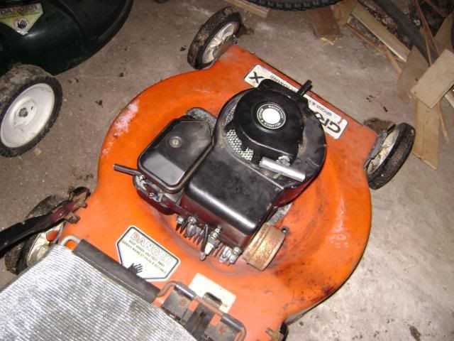

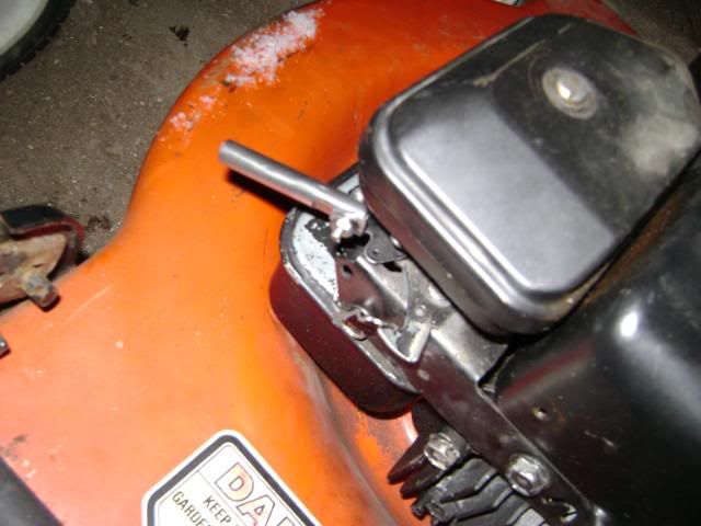

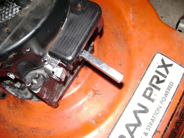

    i hate spending money sence i have a machine shop and as such i have this lawn mower i picked up and its not bad rebuild the carb cleaned the plug fixed the handel..any how this thing uses a 2 cable system for throtlte and engine stop so it was missing all the parts to make thee items work and seeing as iam keeping this one for me ,, i took some aluim amde a new new rip handle, SS for the shut off and throttle noting over giltery but every thing now works and she wil start every time one 1 pull with also very little effort as well on the pulling any how enjoy the pics

            I used to work on mowers for a living. On a B&S engine like that one you can remove the entire brake system ( that mess where you made the lever, the band that contacts the flywheel, get rid of it all ). The only part you keep & reuse is the kill switch, squeeze the tabs & remove it from it's mounting on the brake system. It's the same grounding switch B&S has used for years. Now put the switch on the carb linkage ( the square hole is still there so you just snap it in ). Now all the mower needs is the throttle cable & when throttle is mowed to it's slowest speed the carb linkage contacts the grounding switch & shuts the mower off just like it did in the good old days before all the safety crap was added. Rick
