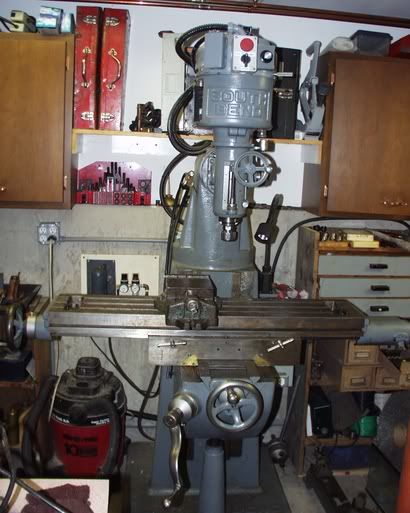

    It is a bit strange, and after having one for a while, it's obvious why this system never caught on. It works well enough though, I've never had a hint of anything working loose. Just a bit of pressure on the screws seats the tool in there very securely, I guess due to the large taper contact area.
    Not real fast for tool changes, but I mostly use the collet holder anyhow, and have all of the collets that it originally came with. And I'm not in much of a hurry.
    Perhaps it is the presence of those two pockets that makes this a "milling machine" taper rather than an NMTB. It seems to be identical otherwise. I have never see one used on any other machine, but I don't get out much, either.
    Here is a picture of mine:
    Not a great view for what we are discussing here, but you can almost see that the motor is mounted directly above the quill. The motor is only about 6" high. These mills used a Fairbanks-Morse or GE "pancake" motor, which is very short and fat compared to modern motors. It was available with either a 3/4 HP or 1 HP motor, and either could be ordered in single or 3 phase. Mine is the 3PH, 1HP unit, I run it with a VFD.
    All in all it is a decent mill for my purposes.
    I can get a few better angles if anyone cares to see.

    It looks like a strange way of securing a 30 taper. One thing that comes to mind is without the same torque on your retention screws, it will work in the taper. The NMTB tapers are far superior to R8 tapers, this can be seen in the contact area of the taper. They are very rigid they can be found in 20, 25, 30, 35, 40, 50 and 60 series. I would also like to see a picture of your mill. I have looked at them in the past but don't remember them not having a drawbar. Old age is great. There is a lot of used NMTB stuff out there, but NMTB 40 and NMTB 50 seem to be the most common as this was most prevelant in industry. I run NMTB 30 in my mill with a drawbar and am very happy with it.

    I'd like to see some pics of the mill, if you've got the time. I'm amassing a collection of mill photographs. Sort of like my own, personal version of Tony's Lathes.co.uk site.
