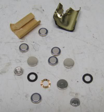

    The other week my digital caliper started blinking at me to tell me to change its battery. But it has always bothered me to have to but a $4 battery into a cheepie $16 caliper. Then by chance I ran across an article about how some batteries are made up of a bunch of these button cells.
    So I decided to check it out. Bought a 12V battery,
    And then proceeded to cut it apart. Where upon I found it was indeed made up of 8 button cells.
    However they where unfortunately a smaller in diameter then what I needed. But no problem that is why we have lathes. So I just turned up an adapter ring to make the cell fit.
    Naturally I don’t expect one of these little cells to last as long as the correct one, but 8 of these little cells I presume will last substantially longer. We shall see. These eight cost the same as one of the correct size.

      Yes, this can be done. ALL higher Voltage batteries are made up from multiple cells. 9 Volt batteries are always made from a bunch of cells. The trick if finding ones that have cells that are compatible in both dimensions and Voltage rating. And different manufacturers may make the same kind of battery from a different combination of cells so brands or even types within a brand may matter.

        I didnt know they were stacked like that!
