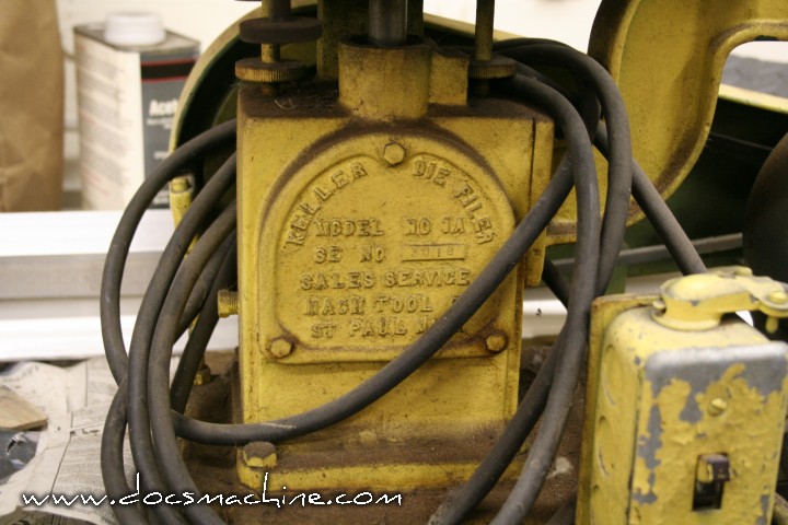

    My latest shop aquisition. Couldn't pass it up for $50!
    Anyone have any info on this brand or model? Manuals, etc.? No files, unfortunately, but a quick look at some of the other die-filer threads notes that Victor and Federal both have files in stock. Anyone have a favorite or recommended shape or style?
    Needs some work and cleanup- and probably a fresh coat of paint- but it turns, there's no damage or old repairs, and only very mild surface rust on the upright and table top.

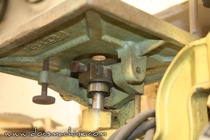

        I have a 2nd overarm, i think for a light. also I dont fully understand how the overarm works. the bend rod that is adjustable, I assume that it is a hold-down for the work. the spring loaded guide part, no idea. maybe i have the wrong type of file in mine? is it suppose to attach to the file somehow? Right now, just have a file stickin up through the table, the overarm/spring part seems to serve no purpose? if anyone knows, enlighten me!
          Originally posted by plastikosmd
          timely.
          Saw blade.
            you are missing the plain overarm with roller that is used mainly with the 8" files. It is still available from the manufacturer.
              Good deal on the die filer. Keller is still around and still sells parts.
              Note that they only now offer the roller top arm and no longer sell the spring loaded tensioner like you have, which is nice for long this files or saw blades.

                            The spring loaded tensioner arm is used to mount saw blades. It is then used as a metal cutting jigsaw. The roller bushing arm is used to backup the files. I have a complete Keller die filer w/both arms, new files, blades & a stand for sale if interested.
                              Would you mind posting a pic pic of the roller arm?
                              My non-spring arm has a horizontal hole the same size as the hold-down bar hole, and I always wondered what that was for. It also seems a bit shorter than it should be. Is that where the roller support mounts?
