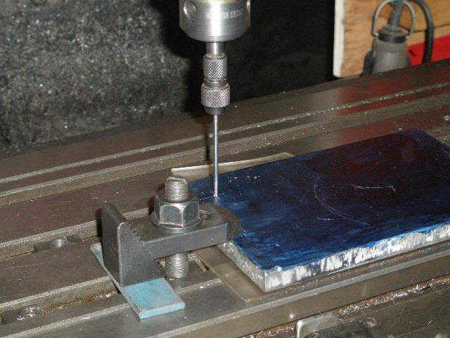

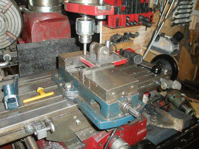

    Starting to find out how handy new DRO is. Needed to match drill 5 holes from a worm gear casting to an adaptor plate but neither side was flat to match drill. Have an Ah-Ha, use a few of the DRO's 200 memory functions. With a pointed pin in the chuck, I located each hole and stored it's X-Y position.

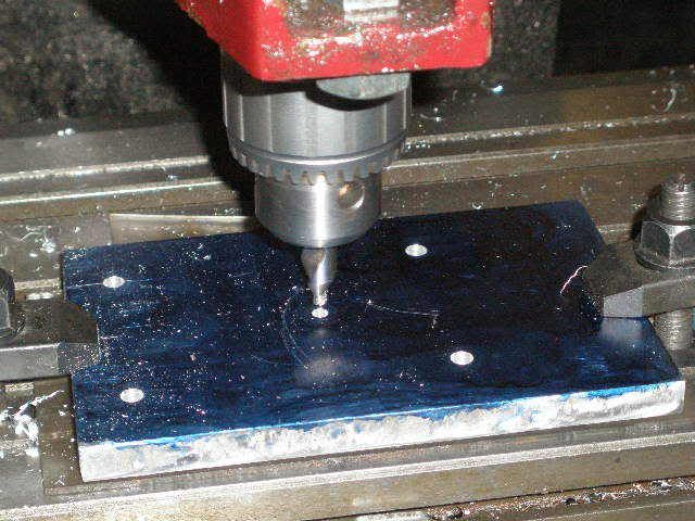

    Punched the first hole position on the adaptor plate where I wanted it, switched to a wiggler and located the plate with position 1 on DRO.
    Switched to a drill and drilled the 5 holes at the memory positions. Thanks somebody for the tip about using scrap Lexan under the workpiece. Will try to get a bright color from the dumpster next time so it's easier to see the punch through.
    If you say nice things, I might show the final product - a windshield wiper motor cranking that mill head up and down. LIFE IS GOOD!
