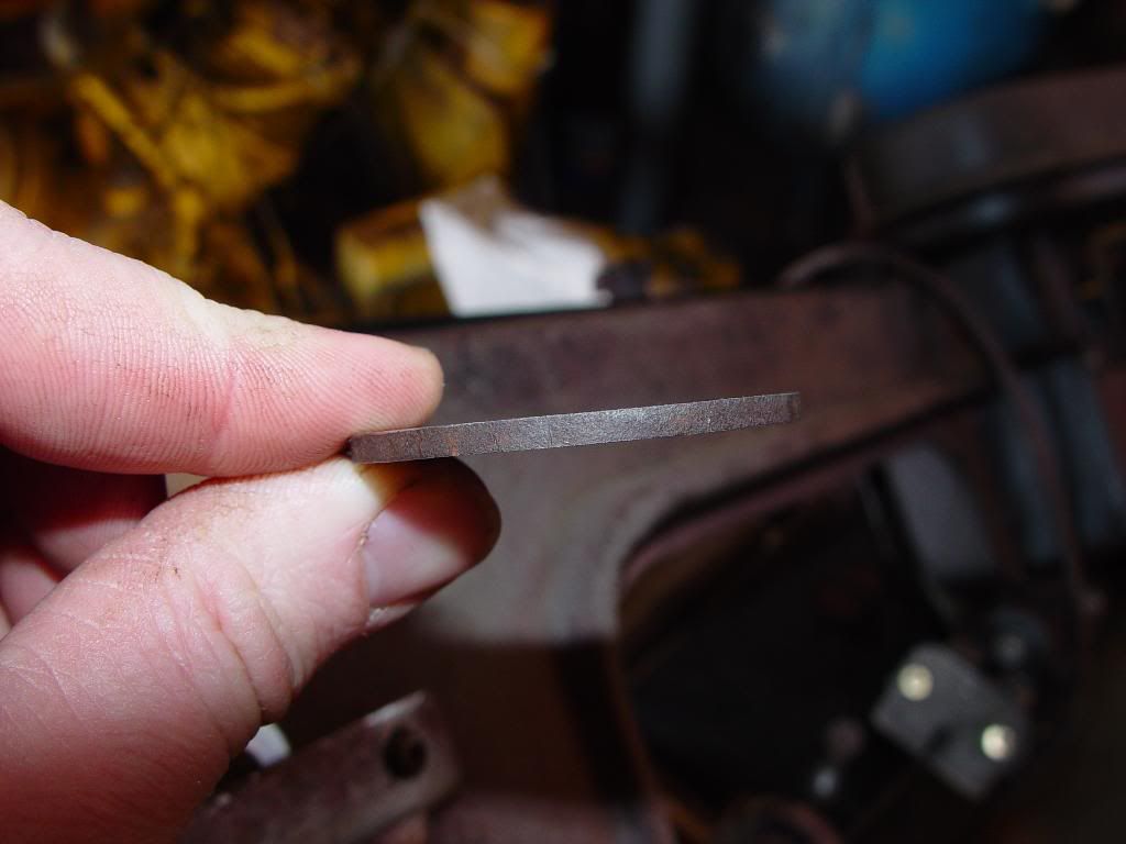

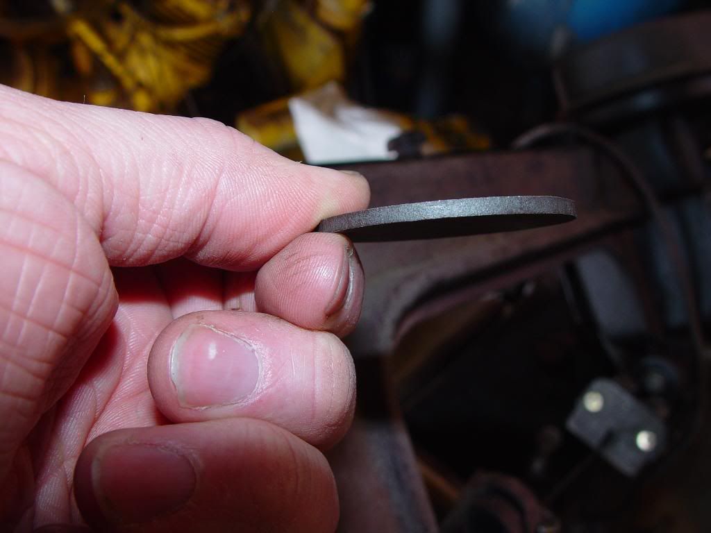

    Seems like I'm always posting questions. I actually got something complete for a change. I've had this bandsaw sitting in the garage for almost a year now. The driven wheel is slightly out of alignment so the blade would spin off after about two revolutions. I didn't really want to deal with it but finally decided that something would have to be done one way or another. I put it back together and discovered that most of the problem was with the idler wheel tilt adjustment forced the idler wheel farther out rather than adjusting the tilt. With a combination of messing with the spacers on the idler wheel to bring it into plane with the driven wheel and a new tilt adjustment it seems to do just fine. I "aligned" the guides with the Mark III Calibrated Eyeball (expecting to do a better job after I verified that everything worked out ok) and this is what I ended up with:

          Man looks like you have it dialed in now........great job, I think I'd just keep the washers er shims as is with those results.......LOL
