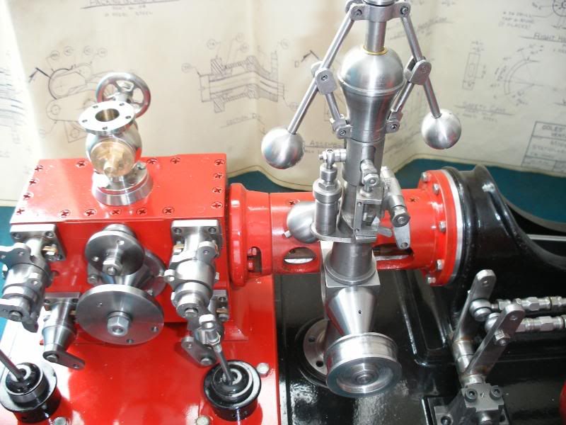

    Such a nice model deserves a better photo. You've blown the highlights.

        Hi Topgun, good work on that model...is it the ''Coles'' one...I am working on the ''Fleet'' corliss model by ''Thorpe'' currently on hold while I am getting a new mill...Love the ''Airframe''quality c/k screws for top of cylinder.

          You look to have made a super job of the machining and general finish, and I hope you wont take this the wrong way.
          Those countersunk screws need getting rid of or disguising in some way, they would never be like that on a full size engine, and to me personally they look horrible.
          That looks like its going to be a super model, how big is it as its difficult to tell in the photo.
          As I said dont take my comment the wrong way its meant to be a constructive criticism not just a put down.
          Phil

                ...what pgp001 said. You've done a super job on the machining, but the fasteners (phillips and socket-head screws) detract greatly. I know scale fasteners are tedious and boring to do (I'm trying to get up sufficient motivation to deal with a bunch of them on my current project), but getting them correct makes a huge difference. Also consider where the prototype would have used studs and nuts vs. bolts.
                Again, please don't take this as a put-down of the huge amount of work you've obviously put into it, but as a way to make it even better.
                  Here is a photo I took of a superb model of a mill engine at an exhibition.
                  The points being made about about suitable fasteners can be seen on this one to great effect.
                  We have an appropriate saying over here which is "The Devil Is In The Detail"
                  Hope it inspires you, it certainly impressed me.
